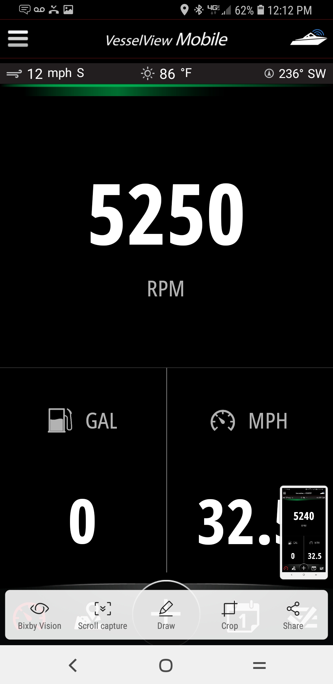

So I have a Starcraft sls3 as well with Mercury 150 and I have tried over 6 props and no matter what I cant get above 34mph. I have the Enertia 15 1/4 ×14p and only get 32.5mph wot at 5250 rpm. Can anyone help please??..?

#9 Post by ron nh » Wed Sep 05, 2018 12:58 pm
I think people on here have recommended 15x15 stainless steel for a Merc 150? You should be able to get the RPM's up. Motor might be to low.
