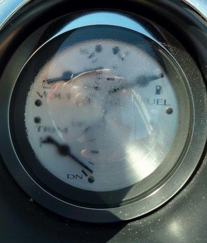

I had moisture problems in my gauges 2 years ago and Bennington replaced them. Now my problem is back and the dealer states this is normal and to turn your lights on to clear up the problem. I tried this and it still takes over an hour to clear up the moisture. Does anyone have a cure for this problem? Does Bennington have a new design to eliminate this issue?

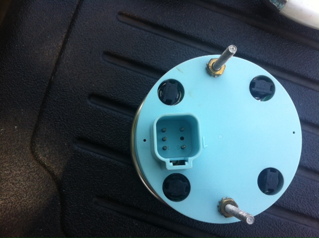

Additional information - The gauge is a vented design - see small holes at the 3 and 6 o'clock position.
Gauge Pic.jpg (106.83 KiB) Viewed 4702 times

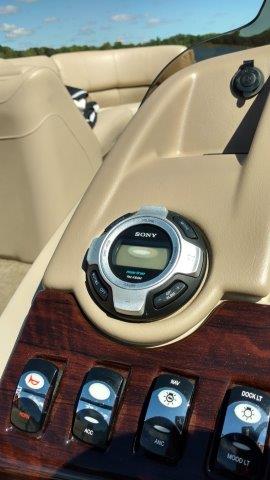

You would think that electronic gauges/controls would solve the problem, but even these are not immune to the problem. My Sony radio control has moisture problems.

Live with it....I can easily see your volts are fine, trim is almost all the way down, and it is time for some gas. :biggrin2

My Bennington gauges all fog up a bit on leaving a dock late at night and cruising back across the lake. Usually, by the time I'm at the ramp, they have cleared up. Yours looks much worse than mine ever gets even though my helm sometimes gets rained on. If I had your issue, I might try completely sealing it or just the reverse - opening it up more under the helm. Under our helm is always much warmer than the ambient temperature due to audio and amp equipment stashed there.
