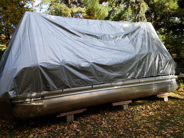

- I covered it with a 20x40 tarp. The steep pitch should keep the snow off.
- pontoon cover.jpg (179.41 KiB) Viewed 8618 times

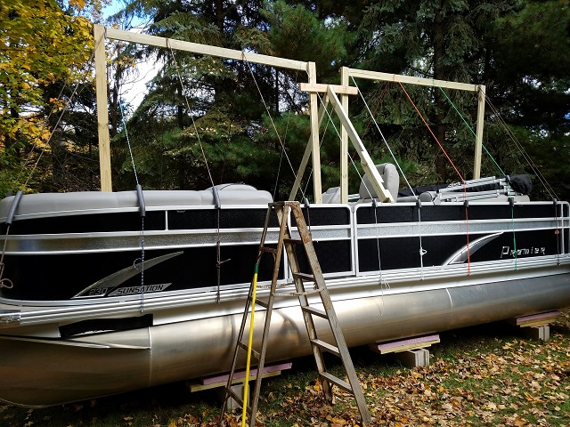

- Well I built a frame from 2x4 and rope.
- pontoon frame.jpg (179.82 KiB) Viewed 8620 times
