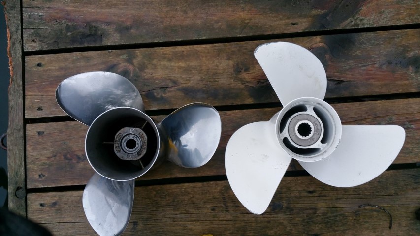

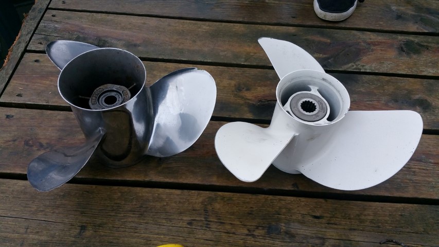

I just bought a 2008 Sweetwater 2386 2 toon with a 2008(I assume) Yamaha 115 4 stroke. First time I drove it we could only hit 20 mph at 3,800 rpm. He had a Quicksilver 17P stainless prop on there, but gave me the original Yamaha aluminum 13 1/2" 15P. The next day I swapped them on now it goes 27 mph at 6,000 rpm. Both times fairly calm, 2 adults, not much else.
A different brand and style and a slight pitch change can make a huge difference. For that motor and boat, a stock Yamaha 13.5" 15P may be the perfect choice.
