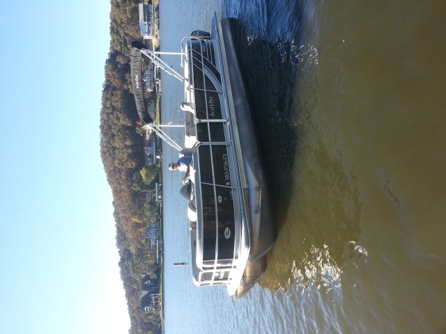

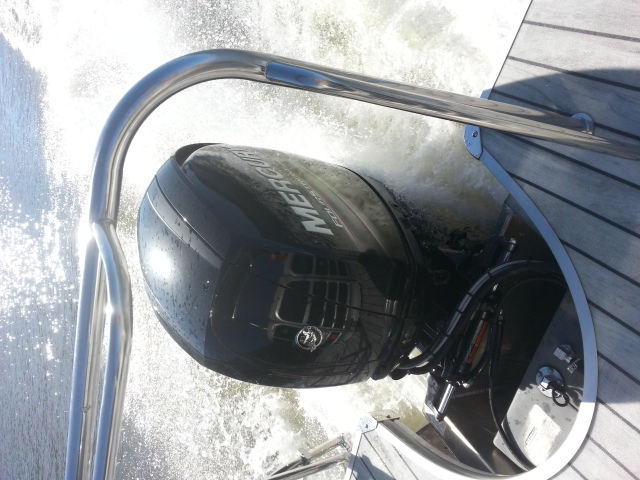

Hi Everyone. I finally got the boat home and in it's new home. We love the new boat and are looking forward to years of enjoyment.
I have had a chance to do a little more experimenting with speeds at different throttle settings. Here is what I have found so far. All the speed are GPS and the trim set at best rpm/speed which seems to be a little less than 1/3 up or 30 on the digital readout.
3000 rpm = 15 mph
3500 rpm = 19 mph
4000 rpm = 23 mph
4500 rpm = 26 mph
5000 rpm = 30 mph
5300 rpm = 32 mph
After doing a lot of reading I believe the engine is set to low. It's on the second hole from the top. I have a lot of spray from around the engine making it very hard to see the anti cavitation plate but I'm pretty sure it buried. I have attached a picture of the engine at about 5000 rpm. I also have a short video but can't figure out how to upload it. I also attached a picture of the new boat.
I am planning on raising the engine at least 2 holes but would like to hear your opinions before I do. Once I get the engine height set I need to figure out if I am running the best prop for my set up. It currently has a Power Tech OFS3R14PCL200 which is 15.25 X 14".
Look forward to hearing what everyone thinks.
Thanks,
Bob
PS. Sorry the pictures are sideways. I tried turning them but it didn't work. I'll figure it out someday.
