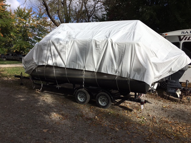

Re: Pontoon cover support.

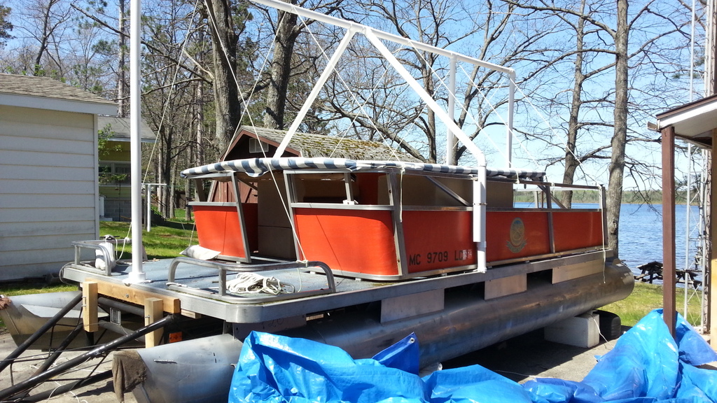

If you want to use normal 45° fittings on your pvc "rafters" you need the center posts to be the same height above the railings as the distance from them--both at ~4'. Add the 26" rail height (or whatever you have) and you cut your posts to 74".
These dimensions will put your "rafter" length at 68". The width of your tarp will need to be 26+68+68+26 = 188" or nearly 16'. Add a couple feet per side to hang down over the logs if you prefer and you can use a 20' tarp.
This will give you a 12:12 roof that snow won't build up on. Store-bought covers typically are much lower so you have to be careful to sweep them off if you live where there's a lot of snow accumulation.
I used rope for most my rafters and that worked out just fine--saved money and storage space.

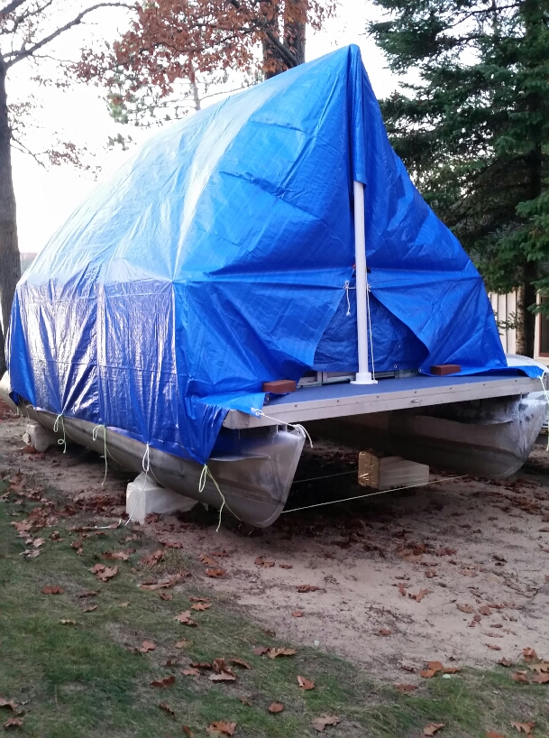

I doubted my thin eBay cover would survive a northern Michigan winter so I followed my own advice and made a new frame & tarp for winter storage of my new(er) boat.

Using the measurements from my earlier post the width is perfect with a 20 x 20 tarp but I could have used a couple more feet in length even though my playpen is only 14 feet in length.
