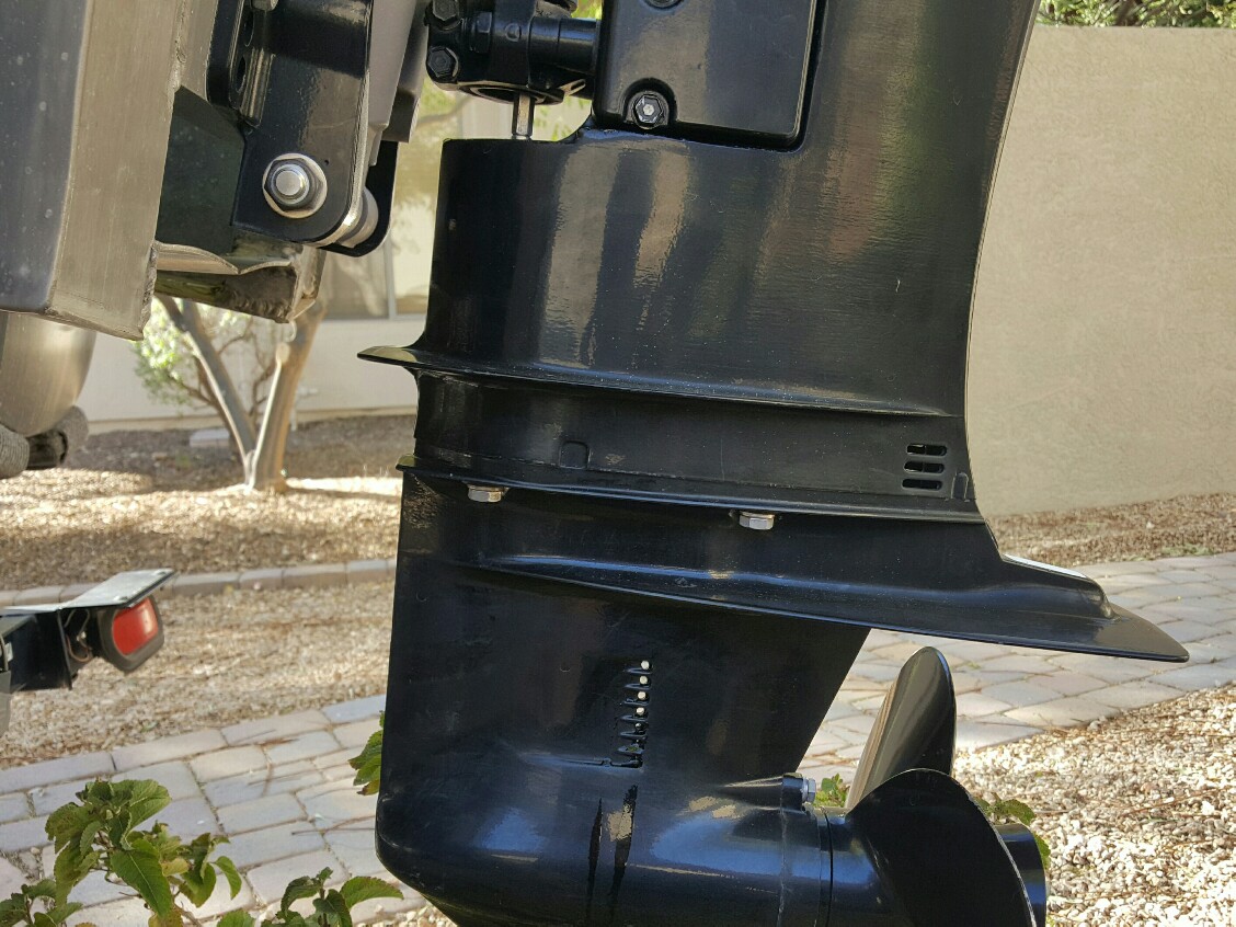

Re: New to Pontoon Boats - Having Issues
Here is a pic.
I can't tell from the pic but do you have bolt holes left on the mount to lower the motor down one notch.
That might help. be sure to leave the bolts in the notched spot just loosen them a bit. and ease it down if there are holes available.
Now with a 50 on a 21 foot pontoon you wont get much "lift" anyway. You may just need to trim for the best speed with the load you have.
On my old pontoon, I kept my motor's anticavitation plate parallel to the bottom of the toons.

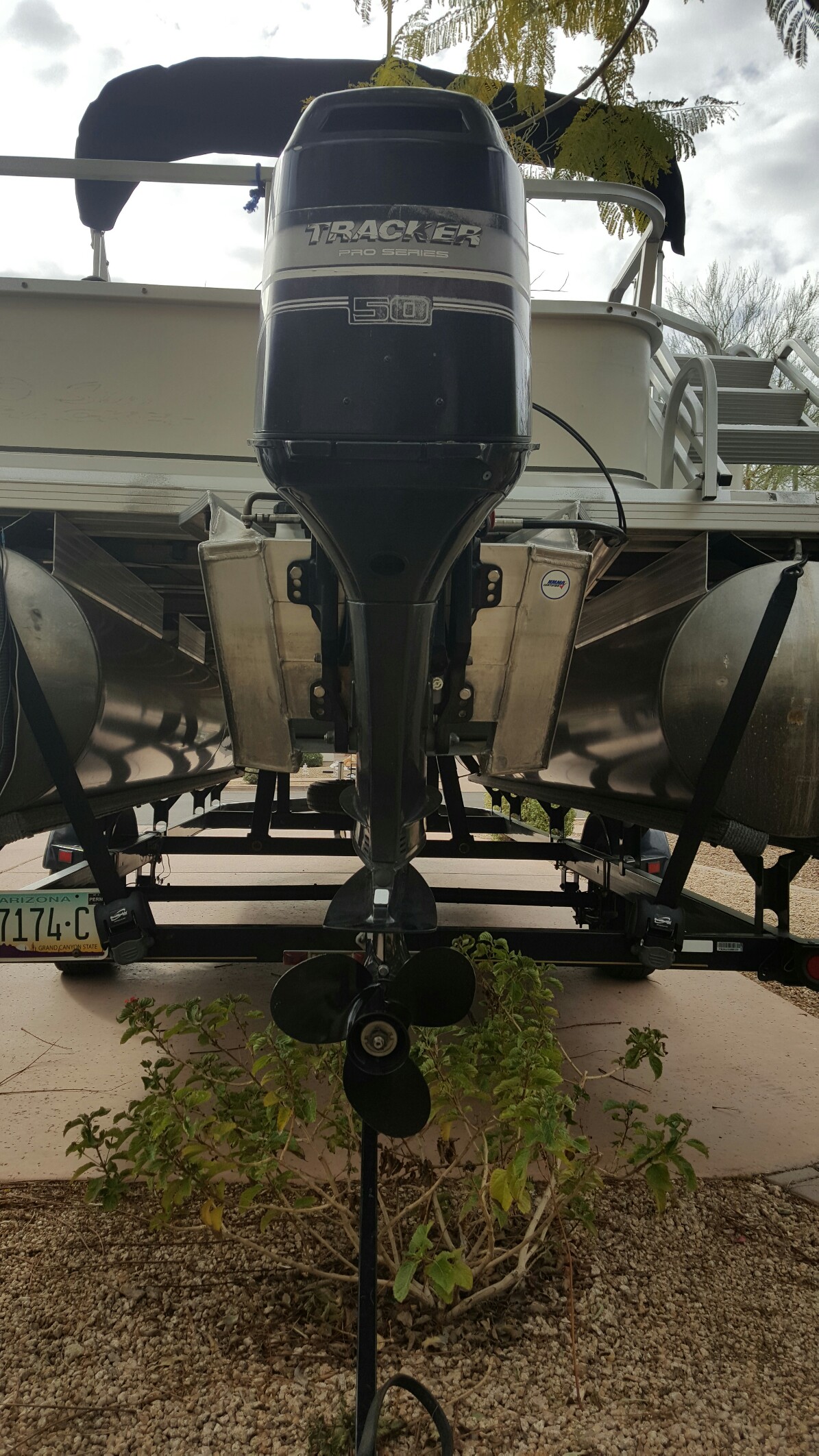

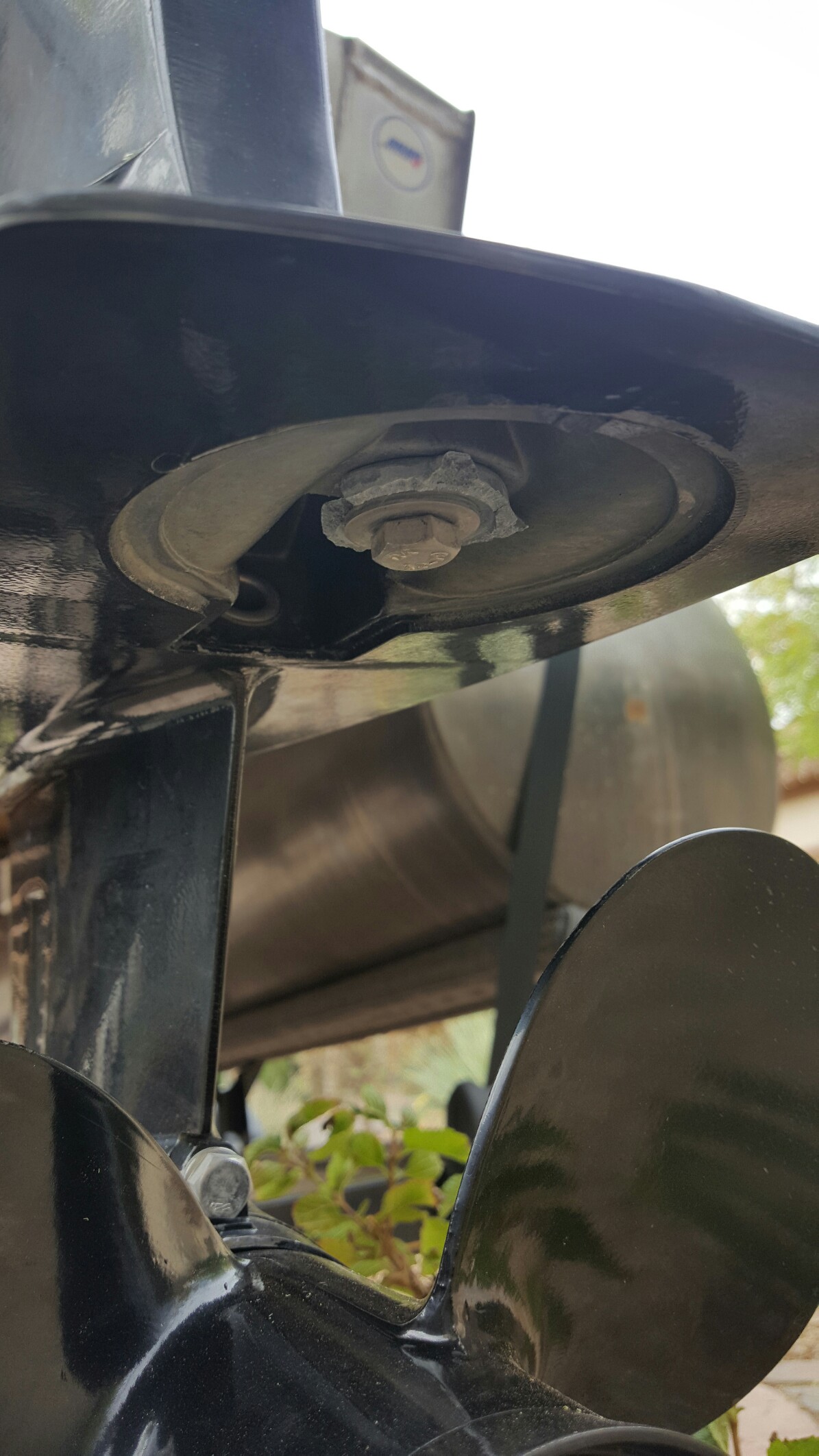

Could this missing piece be part of the issue? Also i included another view of the rear.
On more thing....would a hydrofoil be worth trying out?
