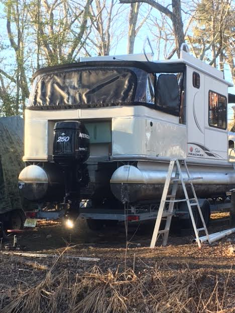

got the 2011 250 optimax installed,going to move the transom back 12",have apt next week so boat mechanic can run it and scan engine for codes etc, strakes to be installed after engine checks out all good.

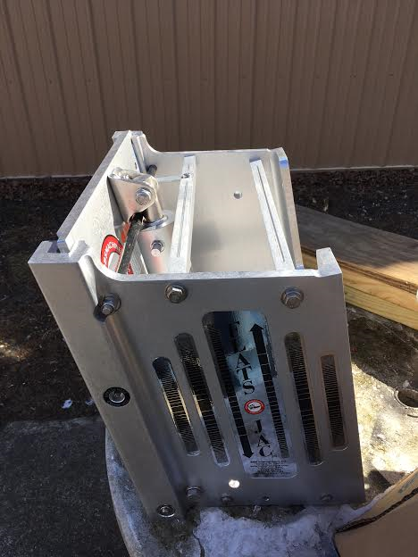

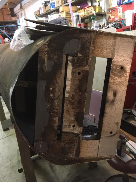

decided to go with a 10 inch bobs hyd jack plate and strengthen the transom a bunch,bobs makes some quality stuff,removed the transom and going to seal all places water normall comes in and install a bilge pump in case anything gets in,eventually I will seal it completely,i am sealing it to get a little extra buoyancy/strength for transom ,

I made a custom center toon out of 2 toons with 50 gal fuel cell in stern toon,added homemade strakes and she does 25 mph presently,gets on plane very quick and such a smooth ride unless the bay is nasty,uses alot less fuel now and rides on top of the water ,going to try a stainless prop next ,peace
