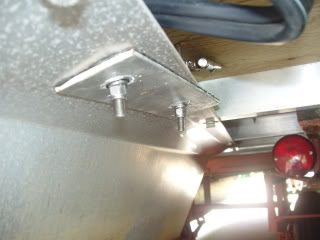

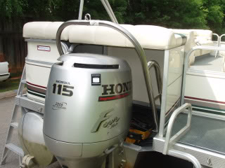

I bought a 2001 Bennington used and later added a ski tow bar. I didn't want to pay the dealer for a Bennington tow bar (don't remember how much it was, but it was expensive). Found one on Craigslist that came off another manufacturer's boat. Sorry, don't remember what kind of boat it was on.

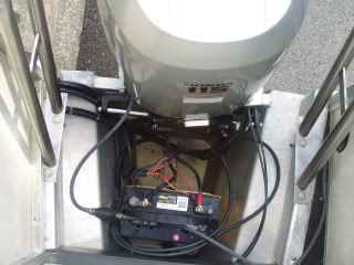

It didn't match up exactly for my boat, but I made it work. I drilled through the motor pod flanges top and bottom and used long SS bolts with a substantial backing plate. Used washers and nylock nuts.
And it's been on there about 10 years with no issues. Use it regularly to pull tubes. Have some pics but can't embed them here anymore. If anyone can tell me how, I'll add them.

#4 Post by sunedog » Wed Jan 25, 2017 5:55 am
Let's see if the pics show up now....

#5 Post by Ned » Wed Jan 25, 2017 9:04 am
thanks for the pics, I was not sure how the Bennington tow bar attached to the frame. FYI, I am looking at a Turbo tow bar- about the same cost but easily demount ed.
