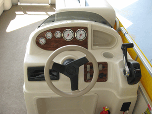

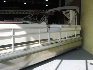

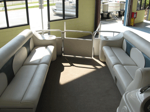

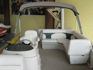

Thanks everyone for all the posts and answers to our questions. We've spent hours/days reading all the info here, talking to dealers, other boaters, everything you all suggested and we found a great deal. We bought a 2423 Leisure Pontoon with a Yamaha 90hp 4-stroke engine. Now, we're wondering what we need to get on the boat to have it ready for riding. Please look at this list and let me know if I'm missing anything:
-Life jackets
-Horn/Whistle
-anchor
-throw ring
-Bumpers (to protect against docks)- What size do you recommend? Gander Mtn has many different sizes. How much line do we need for the bumpers?
- Moring lines - How long?
-Depth finder is $300 installed, but I think I'd add a fish finder down the road and the basic fish finders seems cheaper anyway. Should I just add the fish finder? Are they easy to install?
- trolling motor - How do you mount one on a pontoon? The dealer says I need to cut the front door so that it fits under the door?? What size motor should I look for?
- Extra Battery with switch costs $240 installed. Is this the best option to go in case the 1st battery dies out on the water? Any other recommendations?

Trolling motor is generally mounted to the bow, and when it's stowed, it lays back from the mount on the deck, so that's why the dealer said you need to cut the front gate so it lays under it. Yes, you need the 2nd battery, two extra for a 24V troller, because trollers are heavy load and will drain the batteries. Save your main motor battery so you can get home.

Sweet looking toon, Congrats!
Remember the trolling motor will lay back behind the gate, it is unsightly and will take up some of the floor space between the front seats. I love mine, and have it wired so I can take it off the toon if I want.
