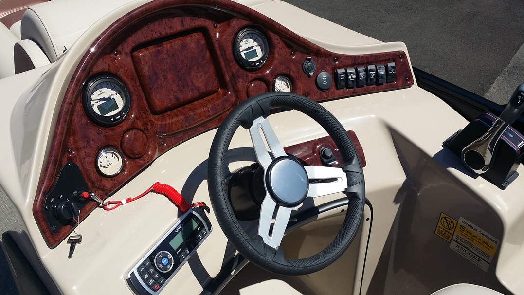

I'm pulling the boat home next week to get my spring cleaning done and add a 10" Bazooka powered sub and put my 8" Samsung tablet in my center dash. One question I have is what's the best way to get power to it? It uses the typical phone type micro usb charger. I will run power the wire through the back of the dash, but not sure how to hook up. Can I just cut the wires on an old charger and splice into power? Would love to hear from someone with experience doing this.
You can see the the perfect mounting spot right in the center where a factor GPS would have gone.

Don't just cut the mini-USB cord & wire it to 12V--you'll destroy your tablet. USB is powered off 5V.
First time I wanted to hard-wire a 5V adapter behind the dash I just cracked open a lighter adapter & used the pcb inside. This is a much better solution and doesn't require soldering:
[img]http://i.ebayimg.com/t/DC-DC-Dual-USB-O ... YM/$_3.JPG[/img]
http://www.ebay.com/itm/Dual-USB-3A-6-4 ... SwdzVXkOX2
If the links don't work just look for "5v buck converter" on eBay or Amazon and take your pick from hundreds under $10.
Another option is a USB dash-mount outlet that has the step-down converter built in. Many aren't truly waterproof but many do include a plug to keep water out of the jack when not in use. You can buy 1-foot USB to mini-USB cords to keep it neat.

I'm installing several tablets at work right now. Ram mount sells a good 3 amp charger that wires direct into your fuse block and has a female usb.
http://www.rammount.com/part/RAM-GDS-CHARGE-V2U
Should be water proof also.

The easiest way would be to put an additional USB charger like the one on the right side of the helm in one of the unused gauge spots. You also could pull the dash away at the bottom just a bit and run your charger cable behind it and carve a little notch with a dremel that the cord passes through and have the cord there all of the time. Then you would need either a cigarette lighter with a plug in usb charger or hard wired usb charger. As for mounting ram mounts work well. I've also played around with a few using headrest mounts that are modified. Right now on ours I used industrial strength hook and loop fastner to hold our 8 inch tablet. I actually like the velcro now even though it was intended to be temporary. It actually gives it a flush mounted look and is easy to remove the tablet. The only downside I've found is you can't rotate it like on a ram mount or other type of mount that is adjustable.

Thanks for the great info. The step down converter is a great idea. For mounting, my plan is to use heavy duty velcro strips to hold the tablet horizontal in the rectangular bulge that was the original cutout. The 8" tablet fits perfectly in that space. I could always just run a short cord to the cigarette lighter or USB port to keep it charged as well. I like the idea of no wires showing though.
I will be using a waterproof case on the tablet it for when it rains. The ability to see in the sun in a concern, but these Samsung tablets can get super bright so may not be too bad. Can't wait to get the pontoon home for the spring clean and Bazooka and tablet install!
