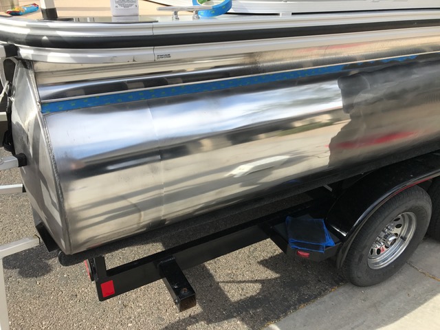

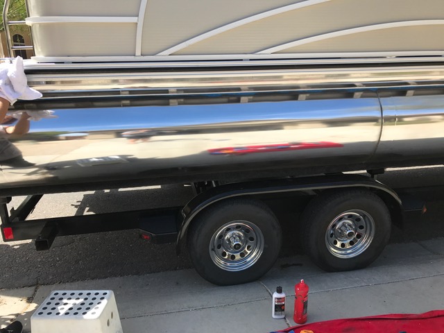

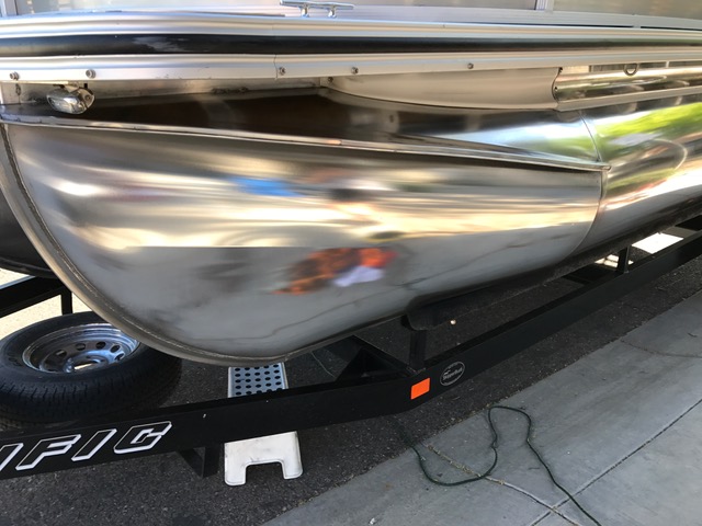

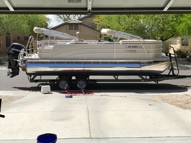

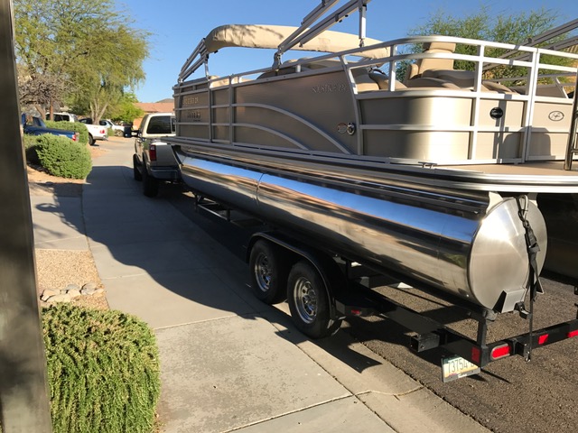

Hey guys and gals! After having this boat for a couple of years, I finally got to the point of "not being able to handle it" anymore. Decided to spend some time polishing the toons. Tons of work but happy with the results. Used white diamond metal polish, a dual action polisher, lots of buffing pads and microfiber towels. Ended up doing around 4 coats to get the right shine. Used 2 coats of sharkhide protectant and took to the lake last weekend. After hosing off with fresh water, the toons wiped right off with absolutely zero water spots. If the sharkhide works like its supposed to, I'll just have to reapply once a year, which only took 30 minutes or so. Hopefully it works as advertised because I don't want to ever polish like that again!

As far as process goes.. (all application and removal was done with a dual action polisher with the appropriate pads)
1. White Diamond Metal polish with an applicator pad. Small sections at a time. Let dry (couple of minutes)
2. Drink a beer
3. Wipe excess polish off with microfiber towel
4. Use polishing pad and go over surface thoroughly
5. Repeat process on same section until desired shininess is achieved
6. Once you're satisfied with shine, finish with a finishing pad over section.
7. Drink another beer and proceed to next section
For areas that are more stained, I used mothers rubbing compound on the applicator pad first and then started the process at step 1 listed above.
After all tubes are finished, I went back over everything with mothers finishing compound to reduce the swirl marks which made a huge overall difference. Once thats done, you just apply sharkhide protectant as directed. This is the easiest step as it just wipes on.
All in, this could've been finished in 2 days. I took my time and drank plenty of beer....my OCD led to it taking 3 days.
If you decide to take this journey, just know that it is lots of work, but the results (IMO) are worth it.
