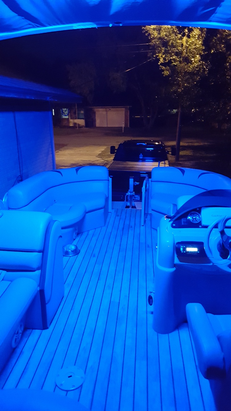

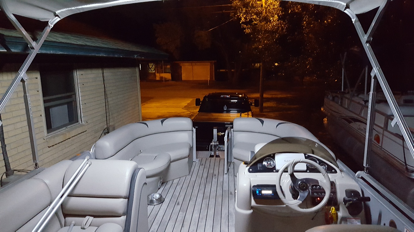

Just put this new light bar on this weekend, a vendor on The Hull Truth boating forum is selling these http://www.thehulltruth.com/parts-forum ... -45-a.html since the light bar already has the switches built into it, there's no need to pull a switched leg, and since most of us already have wiring going up into the bimini for the anchor light or an overhead light (in my case) it was super easy to install. He has two types Red/White or Blue/White, and for anchoring or hanging at the island at night, or boarding folks at night this light is incredible.

This one has 2 switches, one for each color, built in. You can tie it into the factory lighting and then turn it on or off at the unit.

CAPT. MPILOT, is correct, the light bar has its own switches to select white, blue or both. It attaches with stainless clips that take one screw into the Bimini bow, then snaps onto the extruded aluminum bar. Light the night vendor is sending me two extra clips, here is why: the Bimini bow has a radius, the clips attached at both ends, they slide on the extrusion so they could go anywhere. But at the ends they make the ends of the light bar flush with the Bimini frame. Now there is about a 1/2 to 5/8 inch gap in the middle of the 23 inch extrusion, but the aluminum is flexible, so with two extra clips, I can pull the middle section down and keep the spacing even along the length of the light bar. The boat is a Berkshire which is the same as the excursion, I have the same switched light up on the Bimini bow, and it is on the second bow back from the front bow, of the 4 bow top, it angles slightly forward, it will only be used at anchor, on the beach at night, or docked at a restaurant for boarding and departing the boat. My original light up there was only "hot" when the navy light switch was on, either full running lights or anchor light, so hooking it to your anchor light power leads would work fine, very low amperage draw with led, and it has its own inline fuse. Hope I answered all the questions. If your looking for a full all around blue or red cool led that will light your entire deck area and no extensive wiring to do, this is the ticket.
