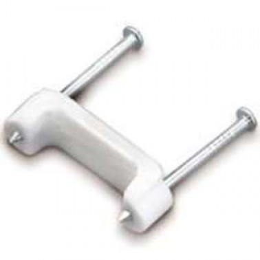

#3 Post by Bryden24shp » Tue May 16, 2017 3:04 am
A neighbor of ours just installed his with electrical staples. He asked me to check it out and they actually look really nice and hold the strip on very well! With the 3m tape and these, they may them hold up very well. I was surprised at the thought, we'll see how they work after a season or two of getting wet.

[quote="Bryden24shp"]A neighbor of ours just installed his with electrical staples. He asked me to check it out and they actually look really nice and hold the strip on very well! With the 3m tape and these, they may them hold up very well. I was surprised at the thought, we'll see how they work after a season or two of getting wet.[/quote]
I looked at those when I was going to do a strip lite, but these aren't in a strip, they are in nodes. I was going to do the strips, but I can't beat the price on these (free) and I've seen them on other boats hold up well. A friend has a houseboat that is lined with white ones all the way around the roofline and it shines out 6 feet from the boat when they are on and lights the whole boat up.
