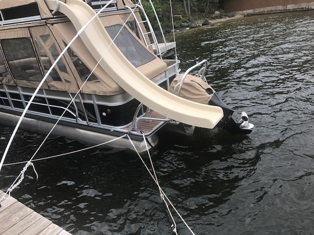

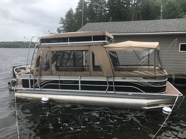

I should have mentioned that I have to trim it all the way down in order to travel flat even with just me or me and 1 other passenger on board (with that passenger in the front of the boat). I have posted some pics below of the boat at rest. Seems to sit with the weight way too far back. What would you recommend?
Motor is on second hole from the top currently.
I haven't hit anything, but the boat seems to me like it is sitting with the weight further back than it was last year. Perhaps there could be water in one of the logs?
What do you guys think?

Ii think that picture says it all, If you didn't read your boat description you wouldn't know it had a 2nd level, I think that's the reason trim works differently than on other boats. Trim it up a tiny bit and all that weight shifts just enough. I think it's the nature of the beast.
