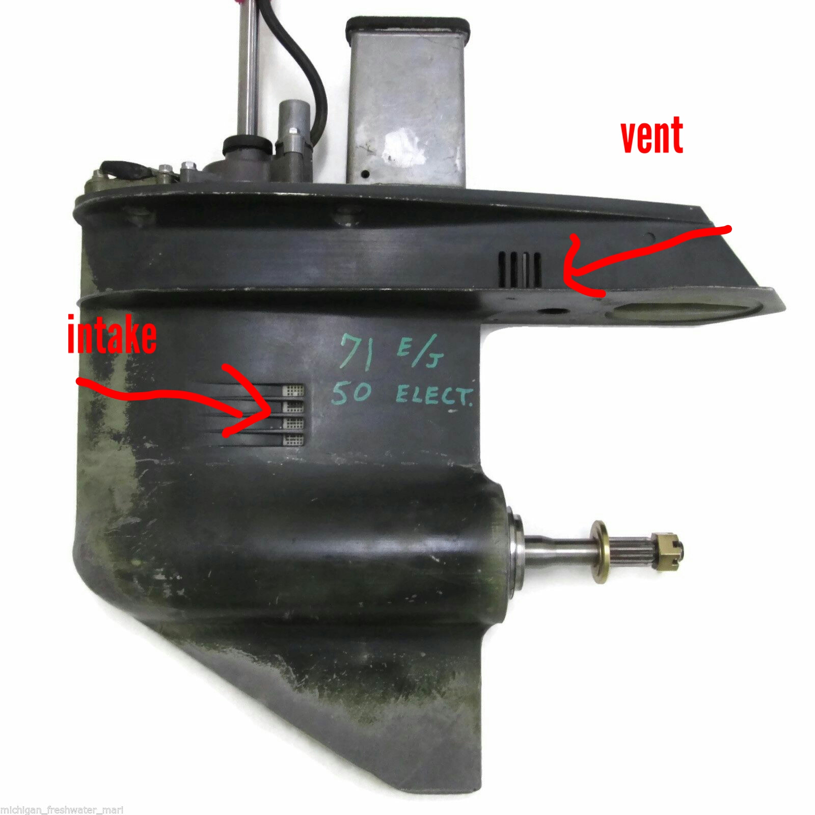

Third, MOTOR DEPTH: So at WOT, I can see the water intake vents, is this normal, would me moving to a proper trim angle help this? I can supply a picture of this in a couple of weeks when we get her back out on the water.

Third, MOTOR DEPTH: So at WOT, I can see the water intake vents, is this normal, would me moving to a proper trim angle help this? I can supply a picture of this in a couple of weeks when we get her back out on the water.I don't think you're actually looking the intakes. The intakes are below the cavitation plate. It would be virtually impossible to the water intake visible while underway, the prop would not be in the water. The part you are looking at is the vents for the mid-section. Water comes out of there, not in.

Sounds like you need to lower your motor.
Seeing the water intake tells me it's way to high.
