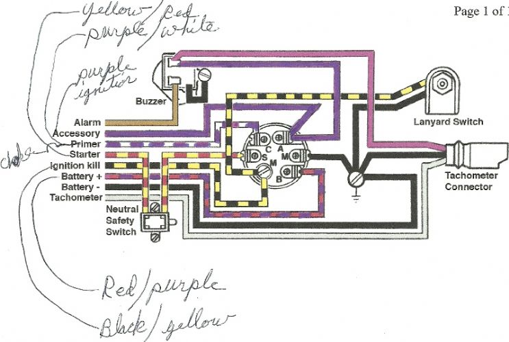

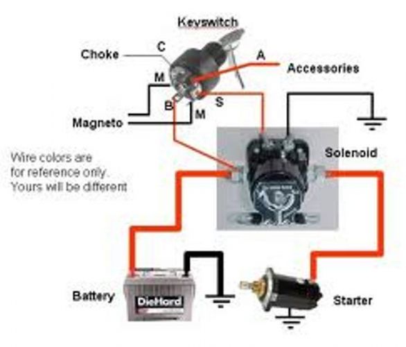

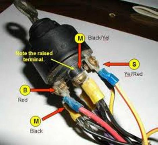

These are Merc but should be close. I replaced switch, stator, and switchbox trying to fix my no start. Was switchbox.

thanks..I know where the wires go..that wasnt what I was asking.
