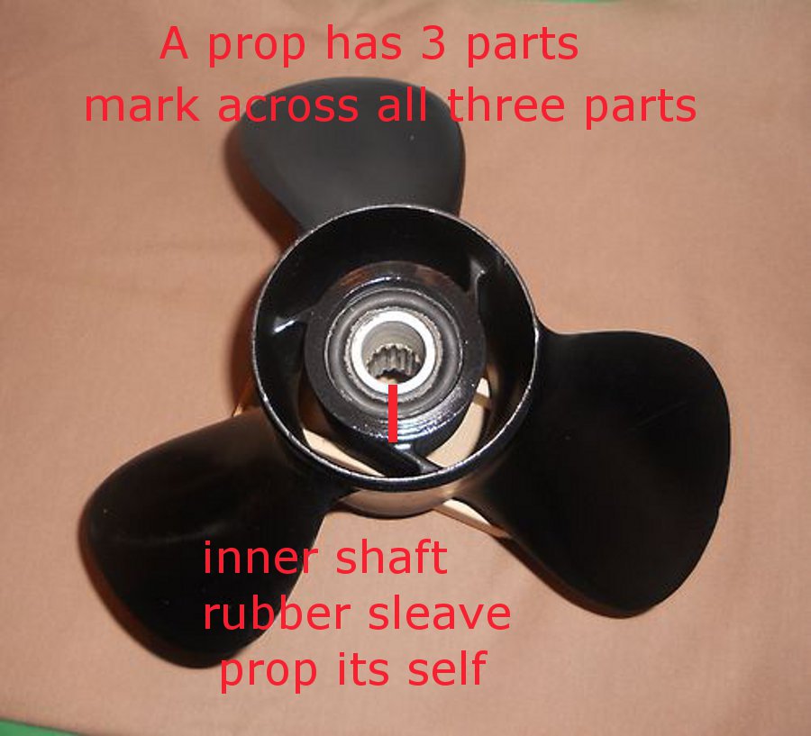

#2 Post by MH Hawker » Sat Jun 24, 2017 11:40 am
thats called cavation, its when the prop loses its grip in the water, and it can be caused for several reasons, motor to high, wrong prop, how the boat is loaded, and so on, it low speeds it may be a spun hub, that is one of the first things to test ( its free ), you do that by marking a line on the prop hub then using the boat, and once back on the trailer look to see if the mark is still lined up
how to mark a prop hub 1.JPG (82.9 KiB) Viewed 2524 times
