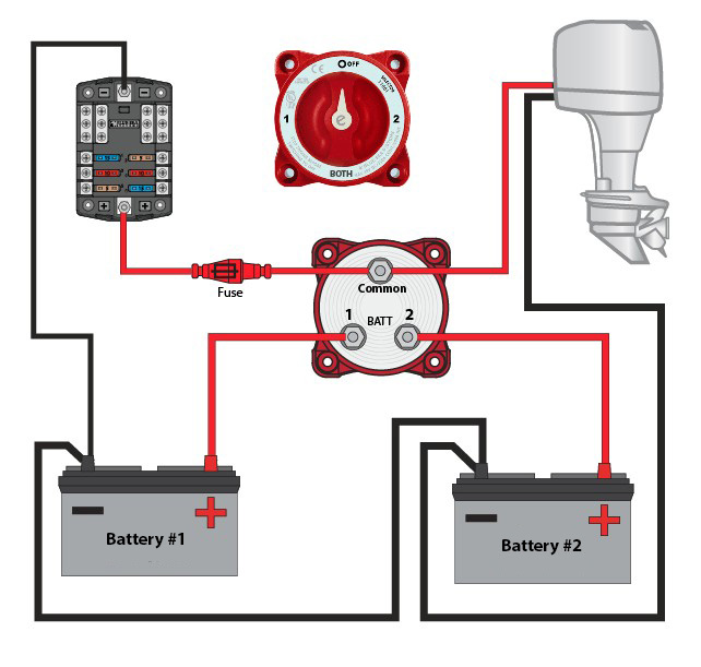

i'am putting a perko dual battery switch on my pontoon boat in the wiring it says to run neg cables to common ground on boat where would i look for a ground terminal or do i have to make a ground to the boat

the negative post on both battery's

Here ya go.
battery switch.jpg (92.58 KiB) Viewed 2766 times

thank you
