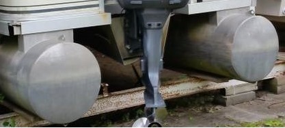

I purchased my pontoon used. The previous owner installed a 150 Yamaha on the boat. The Yamaha is a 25" shaft. My understanding is most pontoons need a 20". When ever I give the motor almost full throttle I notice a large amount of water being kicked up around the cowling of the motor. Think of it as a wall of water on both sides of the motor. I am thinking this is because the motor is sitting to low. The motor also looks like it is bolted as high as it can be. Please take a look at the picture of how the motor is sitting and confirm or deny that the motor is sitting to low. If it is sitting to low would the easy fix be buying a manual jack plate and setting it to the correct height?

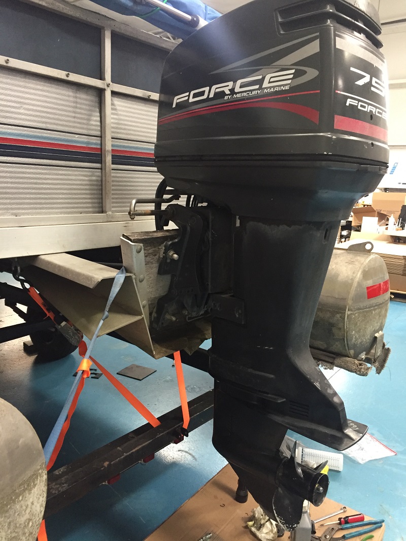

That looks way to low to me. If your transom pod slopes down a lot it might not be too bad but if its fairly flat at the bottom you are way to low. Here is a video of mine when it was low, I raised it up as high as I could and it helped out quite a bit. I would have gone another thole or two higher if I had them.

Here is how mine sits. Don't know if that helps. But it seems fine on mine. I don't remember looking back at it a WOT though. Net time I get out I will and see how much I get.

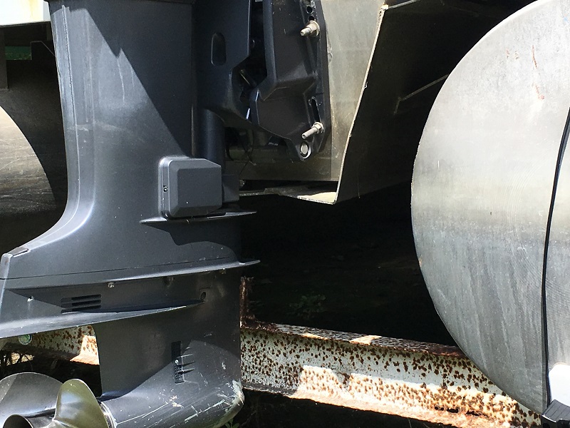

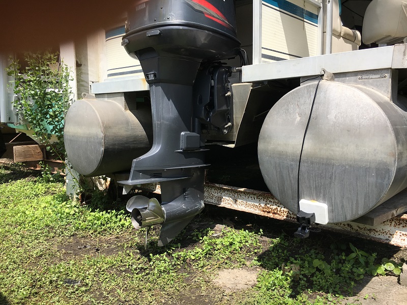

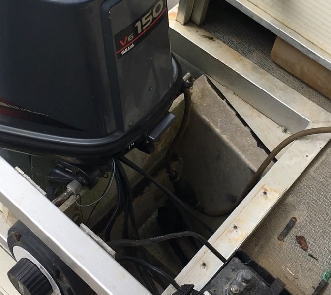

here are some more pictures of how the motor currently sits. I am guessing it is about 4" to low.

Good to know. Here is the pictures.

[quote="cody0707"]I purchased my pontoon used. The previous owner installed a 150 Yamaha on the boat. The Yamaha is a 25" shaft. My understanding is most pontoons need a 20". When ever I give the motor almost full throttle I notice a large amount of water being kicked up around the cowling of the motor. Think of it as a wall of water on both sides of the motor. I am thinking this is because the motor is sitting to low. The motor also looks like it is bolted as high as it can be. Please take a look at the picture of how the motor is sitting and confirm or deny that the motor is sitting to low. If it is sitting to low would the easy fix be buying a manual jack plate and setting it to the correct height?[/quote]
How long have you owned the boat? Looks like the PO just slapped that 25" motor on there for a sale. That is most definitely wrong and won't work in it's current configuration. You could add a manual jack plate to get the motor up, or change the motor over to a 20" shaft, the jack plate would probably be easier and cheaper. how thick is your transom? the one picture looks like it is one 1/4" plate of aluminum?

[quote="FLOUNDERPOUNDER225"][quote="cody0707"]I purchased my pontoon used. The previous owner installed a 150 Yamaha on the boat. The Yamaha is a 25" shaft. My understanding is most pontoons need a 20". When ever I give the motor almost full throttle I notice a large amount of water being kicked up around the cowling of the motor. Think of it as a wall of water on both sides of the motor. I am thinking this is because the motor is sitting to low. The motor also looks like it is bolted as high as it can be. Please take a look at the picture of how the motor is sitting and confirm or deny that the motor is sitting to low. If it is sitting to low would the easy fix be buying a manual jack plate and setting it to the correct height?[/quote]
How long have you owned the boat? Looks like the PO just slapped that 25" motor on there for a sale. That is most definitely wrong and won't work in it's current configuration. You could add a manual jack plate to get the motor up, or change the motor over to a 20" shaft, the jack plate would probably be easier and cheaper. how thick is your transom? the one picture looks like it is one 1/4" plate of aluminum?[/quote]
Yes. The PO told me it was a motor he had on a different boat. I have a manual jack plate sitting at home that has only a 4" setback so hopefully it wont stress the transom to much. The jack plate should be able to raise the motor until the cavitation plate is closer to the bottom of the motor mount. I am not sure how thick the transom is off hand but the PO said the motor has been mounted on the boat for about 15 years and I haven't noticed any issues or cracks in the transom.

I would first see how fast the engine will run in a straight line. I'd think you'd be happy to get 5500 to 5800 rpms. That tells you if you're propped right.
Then how does your boat handle in tight turns. If the propeller ventilates, chances are your lower unit is too high.
They always say you should be able to look down and see the anticavitation plate when running at a fast cruise. That's not always the case with pontoons because each brand and engine configuration is different. My tritoon is setup perfectly, and all I see is spray over the lower unit.
Your engine pod looks like it's well built and a 4" jackplate would probably work. But you might want to adjust your engine up and down first before adding it.

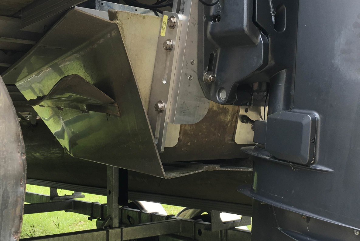

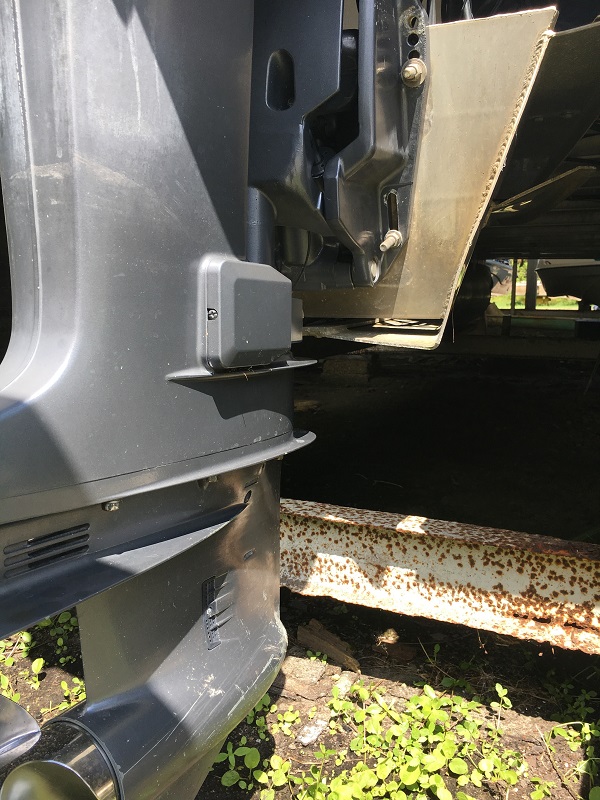

I was looking at other pontoon boat setups. The Bently 240 Cruise is setup like my boat and allows for a 150hp motor. I looked closely at the motor pod and noticed the fins on the side of the pod are forcing water down. A picture of my setup shows the fins are bent out of place. I plan to bend the fins back and hope the metal isn’t weekend and won’t need to be braced to prevent it from bending back up.
Here is a picture of the fin. Also you can see my jack plate to get the longer shaft motor higher up.
- Capture.PNG (1.47 MiB) Viewed 20987 times

Looks like something hit the fin, weird. Its worth a try but not sure if it will make a difference.
