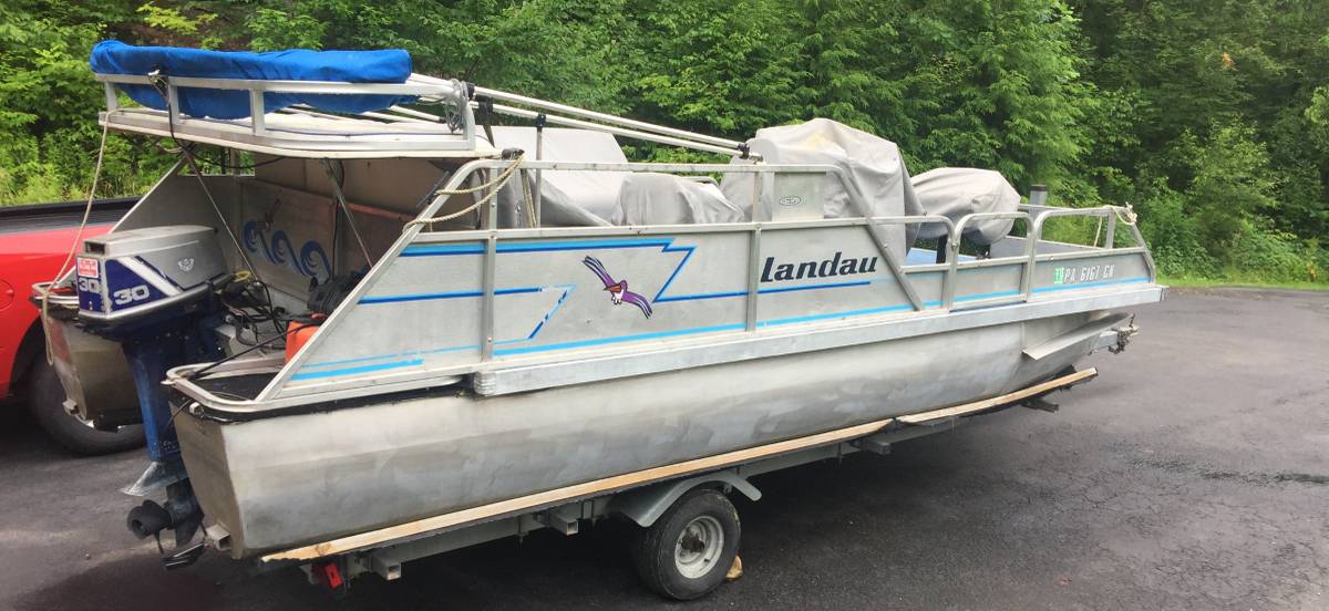

I should be bringing this home in a week or so. The more I look at it... the more I wonder about the rear "sun deck". I can't find a picture of any other toon that has this. And it REALLY looks to me like it would make it darn near impossible to access that motor/gas tank/battery area once the boat is launched.
The rear couch goes the full width. We'd basically have to scramble up over that couch to even GET to the sun deck. I'm 64 and my wife is 60. Not sure we'll be doing a lot of climbing although we're both still capable. I seriously doubt there's room forward of the gates to let me move that rear couch forward. Won't actually know that until I get the boat here.
But some of our boating will be on the upper Niagara River... about 5 miles from Niagara Falls, which probably would not be a fun ride. So, my concern is making sure I have access to change tanks or work on a misbehaving motor while on the water. I don't think that's an unreasonable or paranoid thing. I think it's a common sense thing. But that's me.
What do YOU think? I'd really be interested in opinions.

Anything up river from Niagara falls I would have a backup motor for sure. You may think about a powerful trolling motor for up front to at least get you to shore. Then work on getting things running again. Also some good anchors might be in order.
As for hooking in to the gas. I suppose you could run the tanks under that back seat (with proper venting of course) that would at least allow you to swap tanks if you run dry.
If it were me I thing I would have rear supports added and hinge it to the back so you could flip it backward to access your motor and that way you could leave the gas and everything out there. Obviously this will cost a bit more but seems like it would be more functional. Looking at it however it kind of reminds me of a pop up camper bed. I'm wondering if it doesn't remove or something to give you access. Seems like a pretty poor design if not.
You sure you want to go near Niagara with an old 30 HP? I think If I got anywhere close I'd be scared. LOL

The only way I can see to *possibly* hinge that sun deck would be to hinge it at the side. And then the existing strut support for it would need a total rethink.

What I meant by hinging the back would be to fabricate a frame back there. You'd have to have a frame welded to support the back of the deck, instead of those pipe supports that are back there now. (Those are like how they have pop up campers supported so that is why I mentioned it may already be removable.) Then with that frame built you could hinge it to the back. you'd need to figure out how to attach the front of course and need a support to hold it open (like a hood prop.)
It is doable and could be kind of cool if done right.

something like this

Yeah, that could work. I looked at other Landau toons and noticed the parts where the pontoons extend aft of the fenced area.... on those other Landaus those extensions are fenced so you can access them from inside the boat. Between them was a padded deck where mine is the full width. Lotta re-engineering either way. For the immediate time... I may remove it. Something about having a boat I am not familiar with and not having ready access to fuel, motor, and battery. My wife won't get it... until I start teaching her to run it.

Better safe than sorry for sure. It is a cool looking boat. I'm sure once you get that part figured out you will have a ball on it.
I don't want to see you on the news being the first pontoon over the falls for sure. LOL
