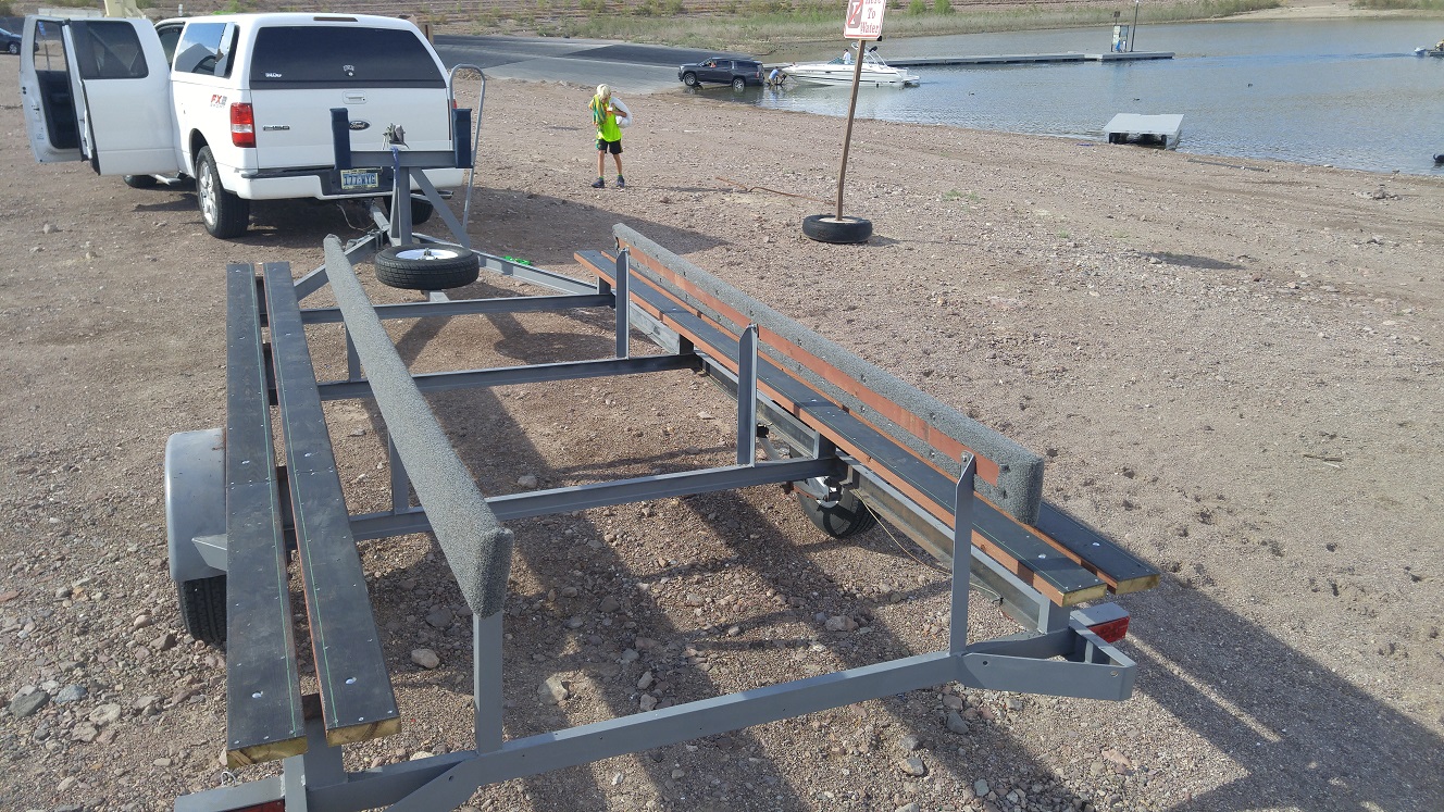

OK, I did use treated wood for my bunks. I used to use PT wood for my ski boat bunks w/ carpet over them and never had any issues so I just assumed to use for my pontoon rebuild.
My question is though that I covered the PT wood with 1/4" plastic and counter sunk the screws. There is no contact of the wood to the aluminum. I figure as well any water would be running over the wood and obviously dripping below.
Soooooo. What do you guys think? Am I safe? I hate to rip it all out and waste about $150+
I am including a pic. We are in a VERY dry climate so they will dry immediately

I would think your fine. In fact even covered with carpet you lessen the chances of corrosion. Plastic in between your probably fine. just keep and eye on it.
My rebuild thread.

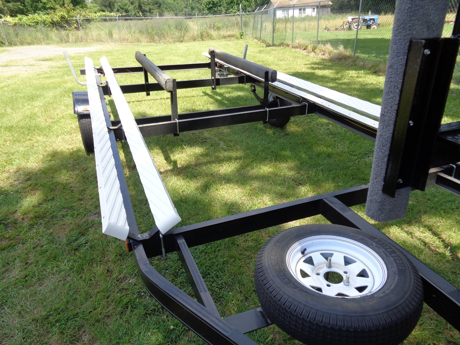

When I first read the comments on this thread I thought oh shxx... I have screwed up. a couple of months back I re-did the bunks on my trailer and I did use pressure treated wood. After seeing the comments on here about the chemical reaction between the chemicals in PT wood and aluminum I did some reading. Turns out ( or at least it is my understanding ) that most of the PT wood that is sold today is Pressure treated with a chemical called MCA - Micronized Copper Azole. And from what I've read it is safe to use with aluminum. However I don't want to risk ruining my toons.. I can't say for sure I bought MCA treated wood...so that's a concern. When I re did my bunks, instead of using carpet I used polymer plastic bunk glides. I don't know how thick they actually are but they seem pretty stout.. and they do provide a barrier between the wood bunks and my toons.. do you think my toons are safe? I'd like to think they are but I have no idea whether any chemicals can ease thru the polymer plastic over time. I would think not, but then again, I have very little knowledge in this area. Appreciate your thoughts guys.
- New polymere plastic bunk glides installed and ready to go 6-10-2017 (6).JPG (904.56 KiB) Viewed 24202 times

I'm sure many boats have sat on CCA treated bunks with carpet over then and did just fine. Plastic over them I think you will never have a problem. In fact if I were doing plastic I would probably lean toward PT bunks just for the added rot resistance since the plastic acts as a barrier and doesn't let the top dry as fast. Sure it drains out the bottom but I would bet you'd be surprised how much water is under that plastic.
