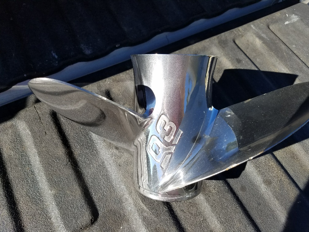

Well I thought i had an Enertia prop on my boat but it is a Stainless steel Quicksilver Q3 prop 15 x 15
i see some sellers on ebay are calling it a enertia, does anyone know what this really is, is has a casting mark of Q3 on it and it does look identical to the Enertia prop. can anyone shed any light on this.
Thanks Mike
Thanks Mike

Seems the Q3 is the generic version of the Mercury Enertia...
Likely no different than the Mercury Spitfire versus the Quicksilver Nemesis, slightly lower in cost but did not come with a hub kit...
Re: enertia props
It's the same prop but a Quicksilver name instead of a Mercury name on it.
Just like the Quicksilver Silverado vs. Mercury Vengeance.
Other examples are: Lightspeed vs (Laser II)
Thunderbolt vs (Mirage Plus)
Torrent vs (Tempest Plus)
QST 5 vs (High Five)
