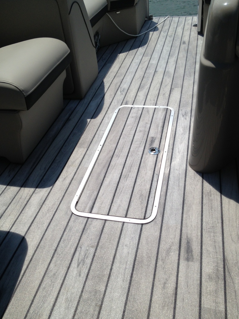

As for your thoughts on the vinyl hatch being a solid color and not matching the rest of the flooring, I solved that problem !!!! I contacted Berkshire and asked them to send me some of the gray teak vinyl flooring and I lined it up and glued it down with a marine sealant to the hatch....... trimmed it all out and it looks great. Has been on the boat for over 2 years. See pic attached.

Thanks for the advice. The storage door looks great! I don't know how they could let it out of the plant without it looking like that IMO. With the other flooring types it doesn't stick out so bad but on the teak vinyl it looks like someone puked on a nice floor. Lol.
teecro
Posts: 1028
Location: Sunset Bay, TN
Re: Ordering new South Bay. Need advice.
#11 Post by teecro » Sat Aug 12, 2017 6:01 pm
[quote="Renegade"]Thanks for the advice. The storage door looks great! I don't know how they could let it out of the plant without it looking like that IMO. With the other flooring types it doesn't stick out so bad but on the teak vinyl it looks like someone puked on a nice floor. Lol.[/quote]
I have a black hulled runabout with a black liner/floor and the ski-locker door is WHITE so thank god for the gray snap-in carpet...
Had to laugh though as I just saw a white on white boat just like and it had a BLACK ski-locker door...
I think the factory workers are color blind!
The sad thing is, ALL of the manufacturers do the same thing...... beautiful flooring, and then the storage hatch door is a solid, puke color vinyl. Geeze, can't figure out why none of them step up and finish it out like it should be. I've seen it on Bennington's, and half dozen other brands.
