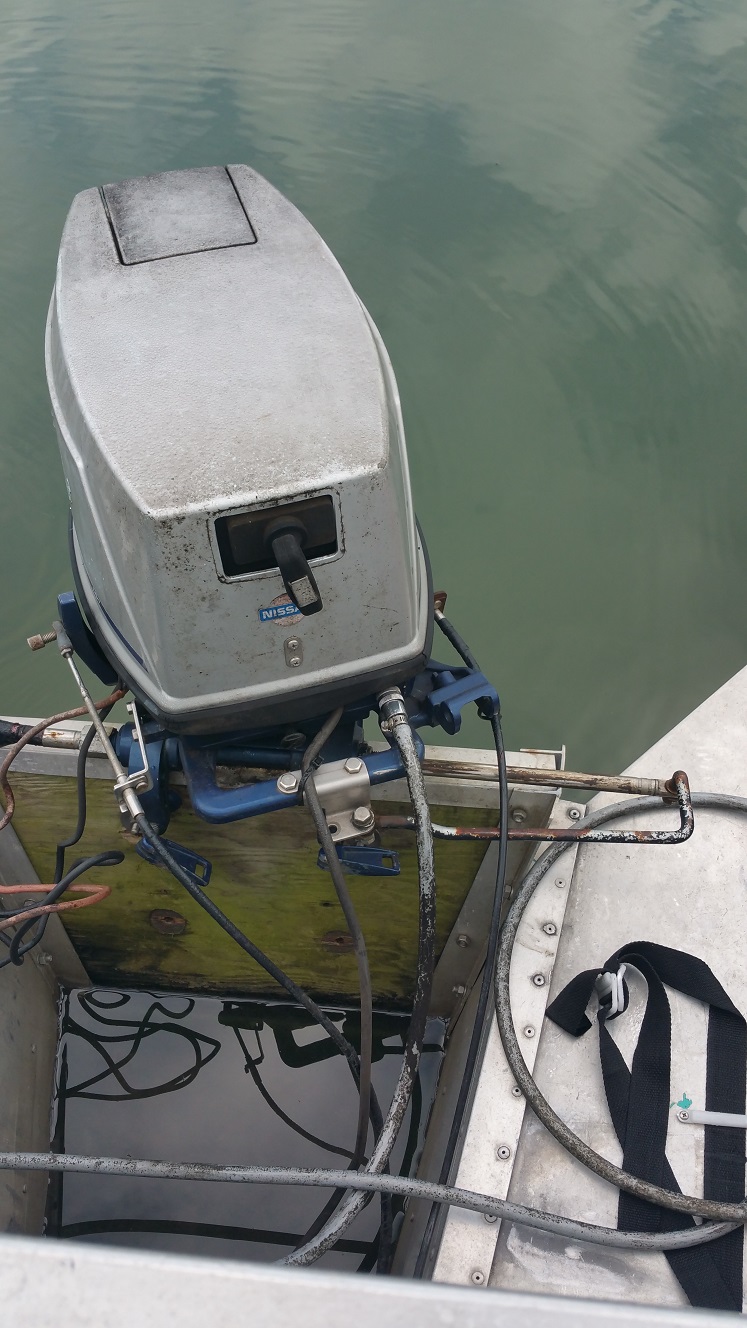

OK... pictures... hopefully...

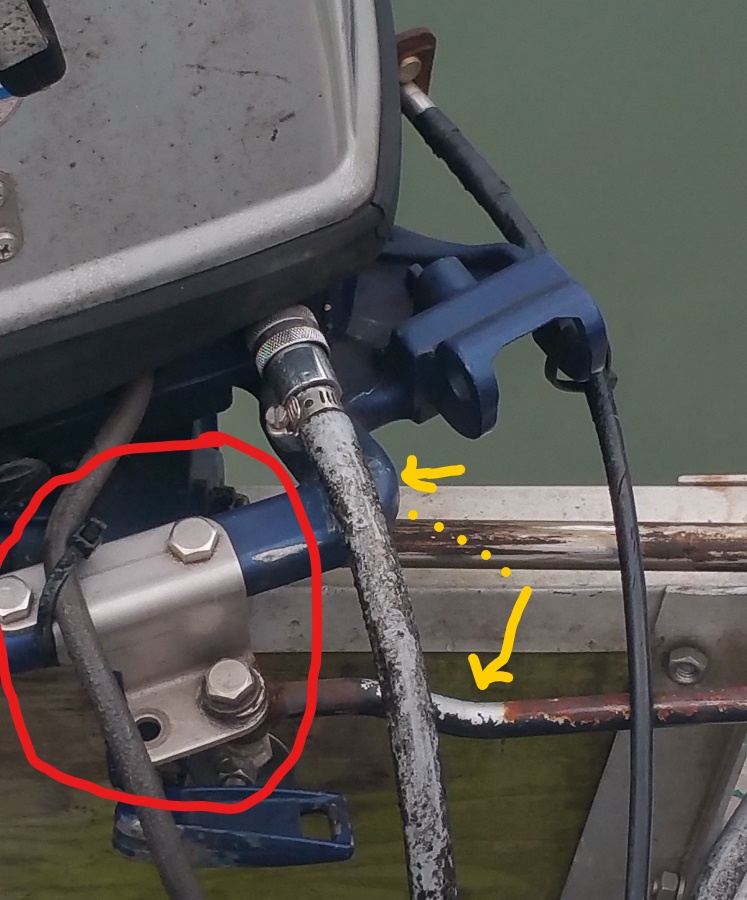

If I flip that bellcrank (circled in red) so the connecting link ( yellow arrow - the larger one) attaches closer to the motor do you think I can get more range of motion when I turn the motor?
That connecting link has a bend in it that looks like it would allow it to pass under the piece the bellcrank is bolted to... (near the smaller yellow arrow)
Because right now this is the motor turned all the way to one side? Does that look like normal?

If the bends on that bracket are 90° then your attachment point is the thickness of the bracket + clearance for the bolt head--about as close as it's possible to get without attaching the linkage directly TO the motor handle.
And that angle at max turn looks pretty typical. I've wanted more myself--esp. when docking--but I assume a greater turn angle increases danger when turning at speed.
Also--those linkage angles do have a purpose. When I bought my used boat someone had assembled it wrong and my linkage hit the platform next to the well and actually had bent the crap out of it when tilting the motor up. Result was unequal turning radiuses.
