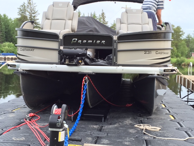

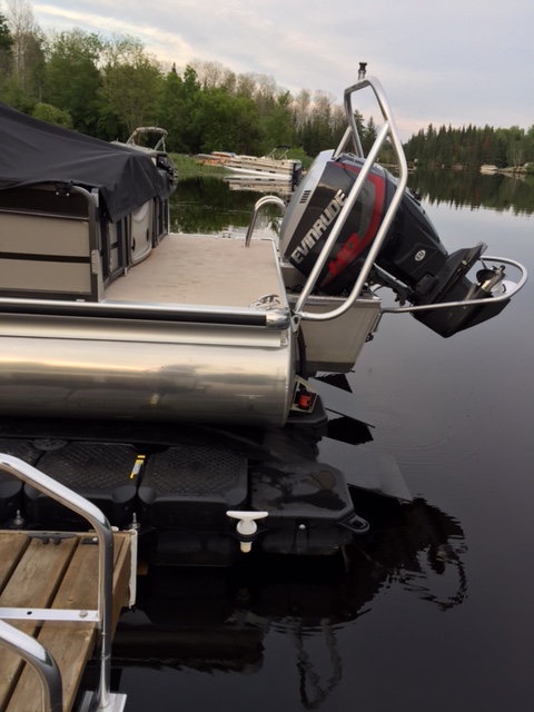

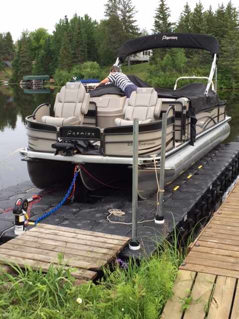

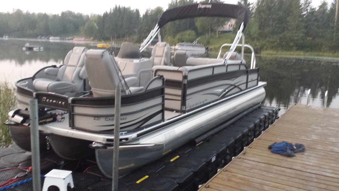

We explored a bunch of different options. Due to a rapid change in the water depth off our shoreline and a mucky bottom, a lot of the lift options available were not a good fit with our needs. Also looked at inflatable bladder lifts eg. http://www.airdock.com/, enclosures that pump out the water around your hull eg. https://dockpro.com.au/products/what-is ... l-sea-pen/ and the Jetdock type drive-on docks. We ended up going with the Jet-Dock system. It was expensive! But given what we spent on the boat, and the length of time we anticipate using the boat, it should amortize out well over time.
Not going to lie. There were headaches and learning curve but in the end we're pretty happy. Having access all the way around makes putting the cover on way easier. Our boat is almost four years old and most people think the tunes look brand new. It can be a little bit tricky to thread the needle in a cross wind, but that's true of pontoons regardless of the lift style.
If I lived further south I think I would go with the sea-pen type enclosure, but for our uses Jet-Dock's been pretty good.
Should note, we're in a pretty protected area just off big water so wave action doesn't get too bad. Wakes and such hardly make a dent. Big boats mean lots more stability on the jetdock than a waverunner might have.

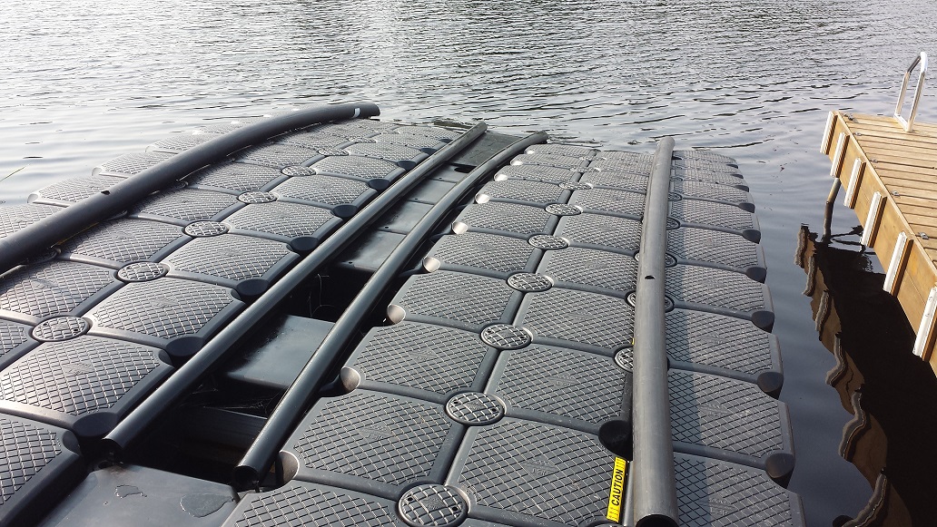

Note that we added some bunk guides to make it easier to line up the boat and it provides some corrective guidance to the toons. this wasn't stock on JetDock, but the messed and sent us the wrong size for centre section and we repurposed them.
