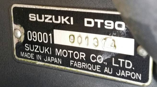

Here is sn, it looks like a 9 but is peeling like a 0

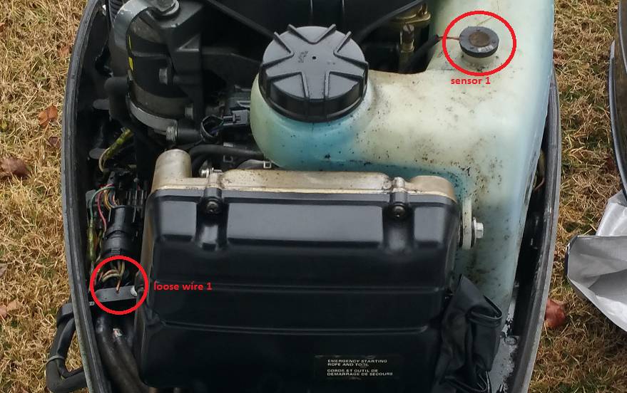

This shows oil level and a loose wire

Just a WAG on my part, but GUESSING I'd say the sender in the tank probably went south and the quick fix was to clip the wire.

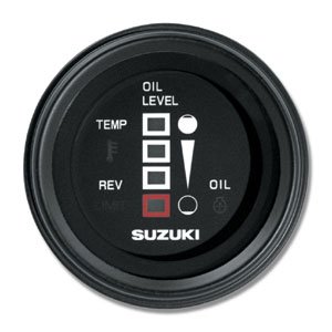

#7 Post by bansil » Mon Feb 12, 2018 8:00 am
good news, I found out the warning lights and the buzzer are incorporated with a gauge in the dash, and it has that gauge, also he is going to send me the service manual for it...getting antsy now :mrgreen:
