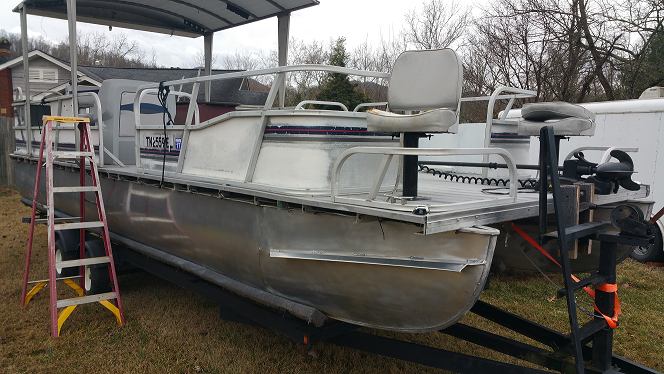

#3 Post by bansil » Wed Feb 14, 2018 1:51 pm
Machinist by trade...a long 25 years of it
I can get any flavor I decide to go with, I don't have my toon yet...just pictures :| got a couple more weeks wait
so I'm doing research :drool
Does the skinning go down the sides a few inches to keep splash off top of tubes where cross members attach? (say rear half)
ETA fingers crossed...our future toon

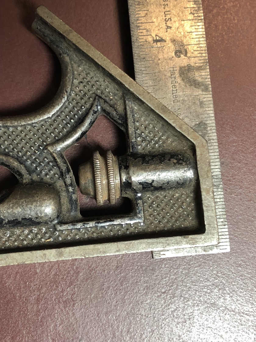

#5 Post by zoom650 » Thu Feb 15, 2018 9:20 am
What thickness? .032
Went old school and measured my bow at 5/64th .. what's that, about .078?
Harris factory option for heavy water.
