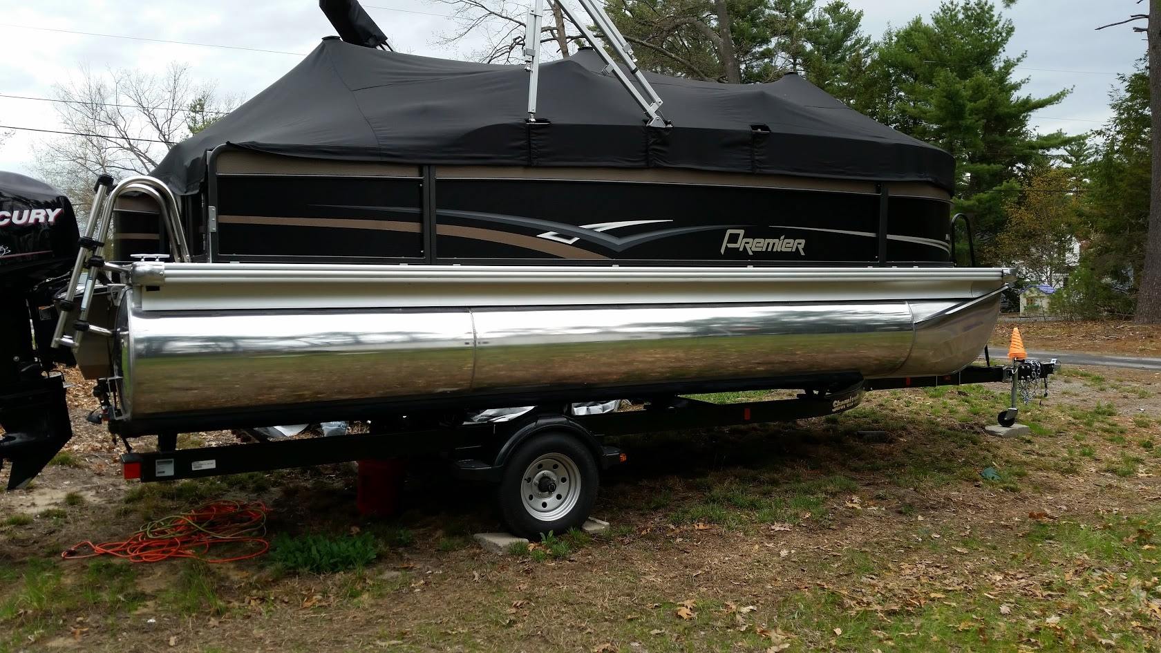

I use Mother's Aluminum Cleaner

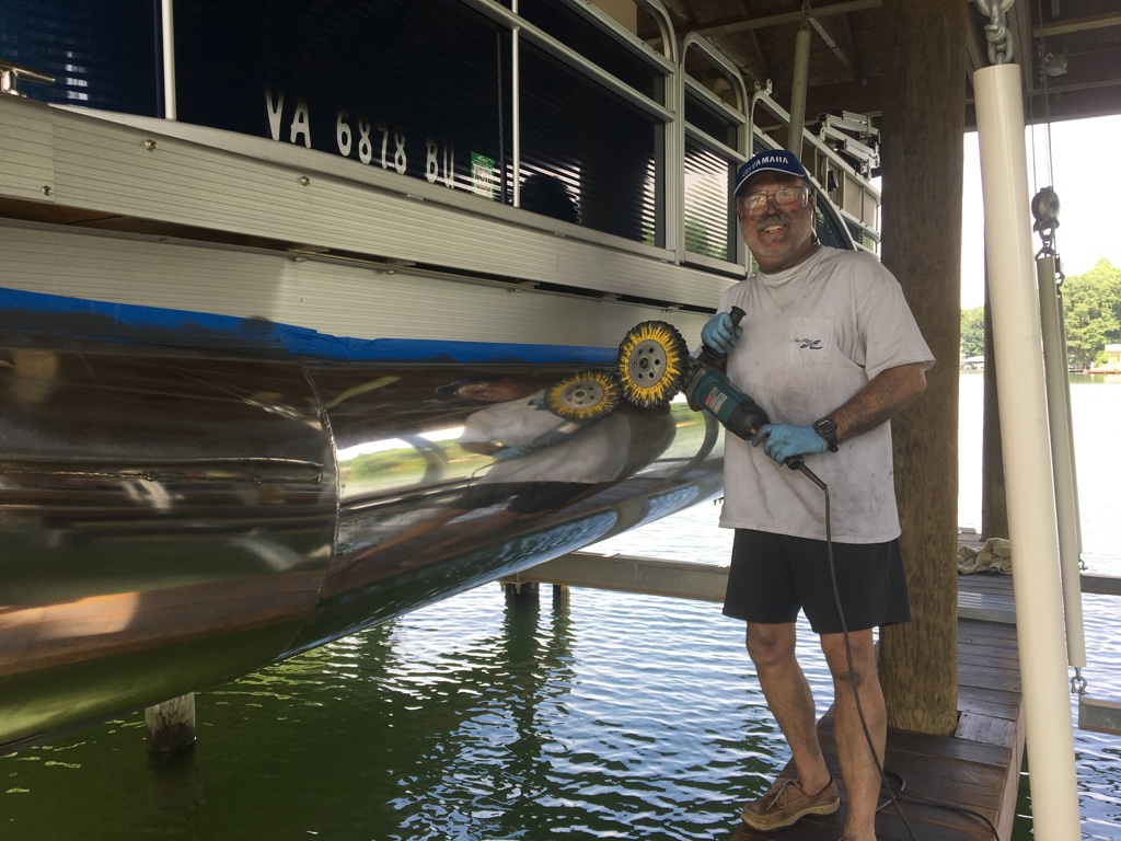

After trying several methods of buffing my buddy's toons with a DA polisher, hand polishing, etc and getting mediocre results, I decided to go big! I used what the truckers use on the polished tankers, and their fuel tanks. I bought some AIRWAY buffing pads and rouge.
Using a Makita variable speed buffer I started with a YELLOW airway pad, and tripoli rouge, followed by using a WHITE airway pad and white rouge. Ended up with a mirror polish finish!!!! These buffing pads cut the oxidation like butter..... Instant results...
While it's filthy dirty work, as you buff it leave next to no residue on the toons. I did wipe them down with lacquer thinner when finished and then applied SharkHide.

Looks good Strake, now put on a N-95 mask at least next time.
Re: best stuff to polish the toons out
Yes..... couldn't believe I did that the first day buffing. The rest of the time I had one on.
This was on my buddy's boat too....... as mine was Sharkhided about 2 years ago, I wanted to get the system down pat before going after mine next season..... LOL !!!
