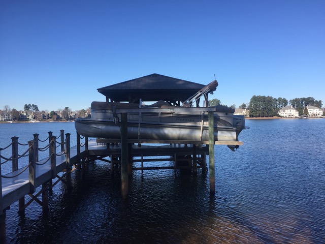

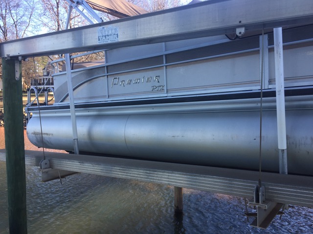

I have a 23' Premier PTX and my lift service company has advised me that there is some damage (flattening) to [img][img][img][/img][/img][/img]the rear of the two outside toons at the point where the rear cross beam is located. He says this cross beam is too far forward from the ear of the toons (4.5') and there is too much unsupported weight at the rear of the boat. Where should the cross beams be located referenced from the rear of the toons to properly support the weight of the boat on the lift?

Pontoons and tritoons do not need to be supported sitting on two cross braces. They need to be stored on a rack that essentially looks like a square wheelless trailer with bunks underneath the toons running lengthwise.

My lift is not sitting on the crossbeams. There are flatboards on top of the crossbeams running parallel with the toons. But those boards are sagging between the crossbeams and not doing any support along the length of the toons.

Sounds like it the lengthwise boards are not properly supported if there are dents. Mine have cross braces every four feet.
