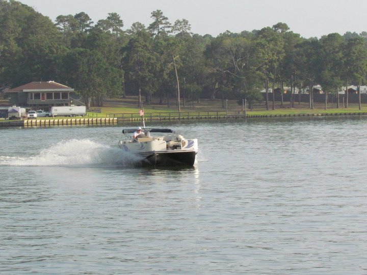

Yep---people in front---keep motor down---if you try to trim you will just blow out. I have a 20 ft fishing model with 2 fishing seats up front-no couches--I can trim out a lot before I cavitate. Still like pushing a big box thu the water tho'
I'm running 28 GPS here.....uhhh--little too much weight on rt side of boat

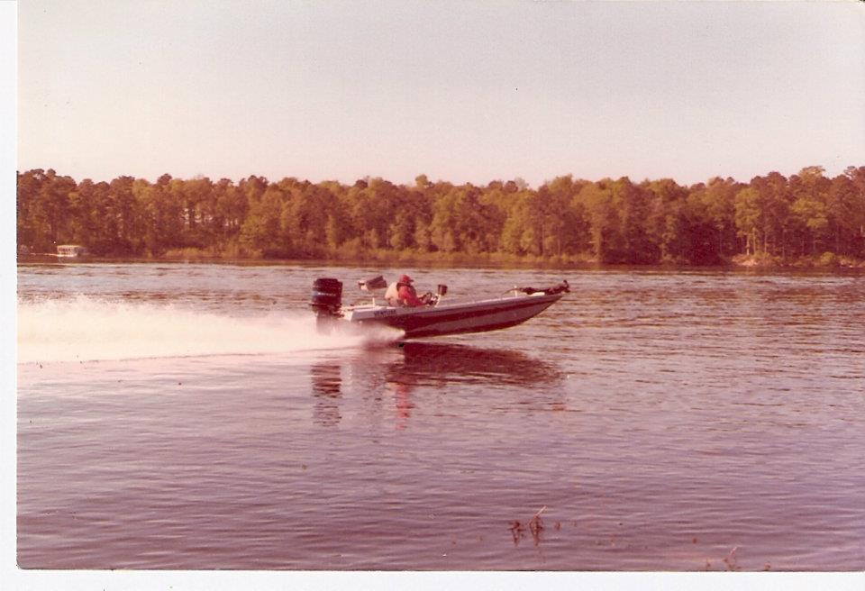

As opposed to my bassboat--circa 1979 Toledo Bend Tx Venture ---115 Merc. 55 mph. Notice motor trim....
- venture bass boat.jpg (76.24 KiB) Viewed 18801 times
- boatpic1.jpg (79.54 KiB) Viewed 18806 times
