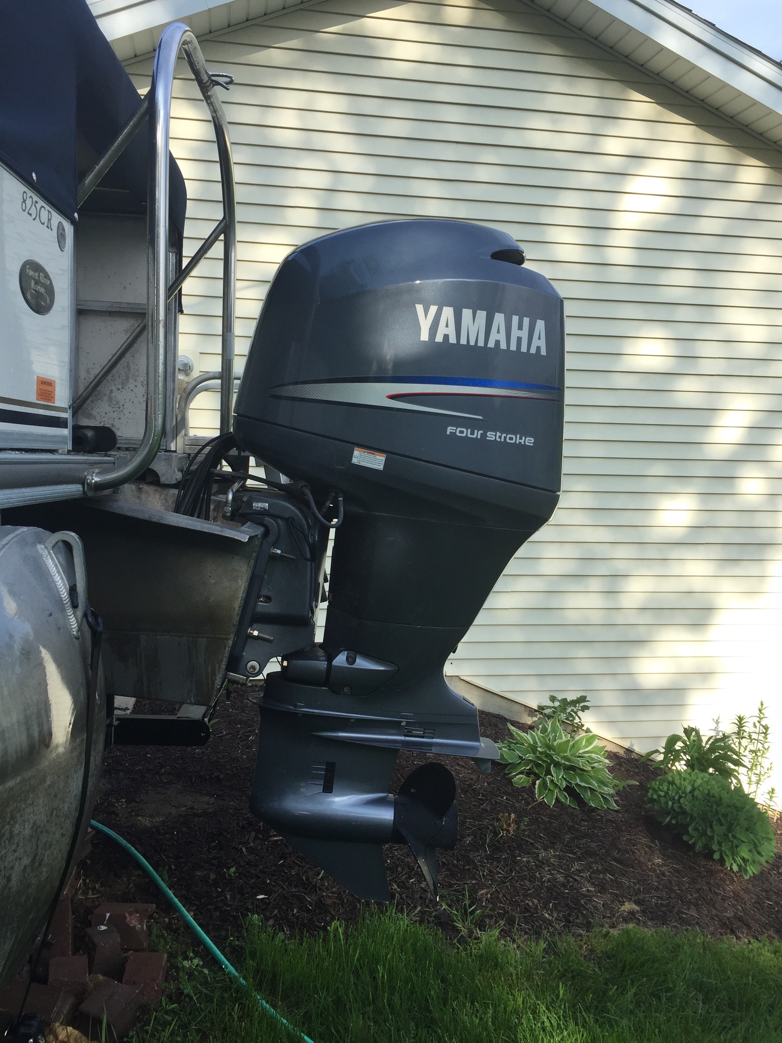

Is that too deep? I don’t think it looks like it. It was just installed at a dealership so I assume all is well.wwind3 wrote: ↑Tue May 22, 2018 2:05 amInteresting.... the 115 rpm's are low too. What boat are these motors on? A pontoon is a lot like pushing a dumpster thru the water. Is yours a tritoon? If your props are working that hard all the time you will probably spin out your hubs in short order.. Mercs usually run in the high 5000's. My 90 redlines at 5850 approx. Good luck.
Oh--make sure motor isn't set too deep in the water. Cavitation plate should be even with bottom of center mounting pod.

- Do you think this is too deep?

looks OK... Is your boat a 26 foot with couches up front. If so---with only 2 toons instead of 3 you may have trouble getting the nose up when trimming..... if I run my 20 ft 90 trimmed down I lose a lot of rpms also.

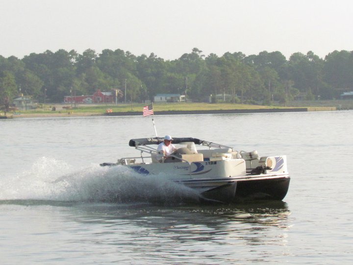

Have enclosed pic of mine trimmed out at 27 GPS--still throws a lot of water- I also have underskinning which smooths the ride and helps speed a little. Getting some pics like this may help you figure out what is going on with your setup. I have the fishing model--so no couches up front. Good luck..

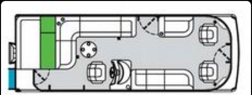

Here's they layout, couches don't make it all the way up, but the pair of captains chairs aren't light either.
I've never noticed much difference in performance while trimming. Maybe I've had the wrong prop all along even with the 115.

^^^^ The pic you posted looks like it’s set up OK to me...
