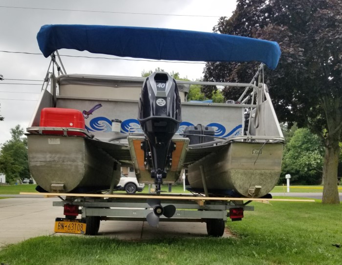

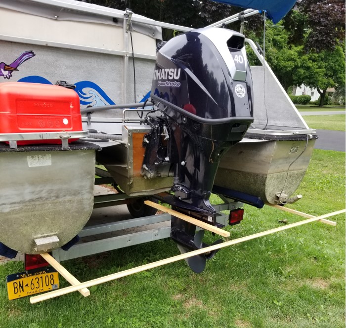

So I set it up to measure stuff...
View from the back. The horizontal stick represents the bottom of the pontoons.
Another shot from an angle...
What this is showing me is that my anti-cav plate is about 2-1/4 inches above the bottom of my pontoons. It's below the bottom of the transom pod, but well above the pontoon bottom. I've watched this a lot when running. The splash plate will run just at or ever-so-slightly above the water surface, but the anti-cav plate remains submerged.
I think this motor needs to be lowered. I think the only reason I don't see the anti-cav plate at the surface when running is because of the wakes coming off the pontoons.

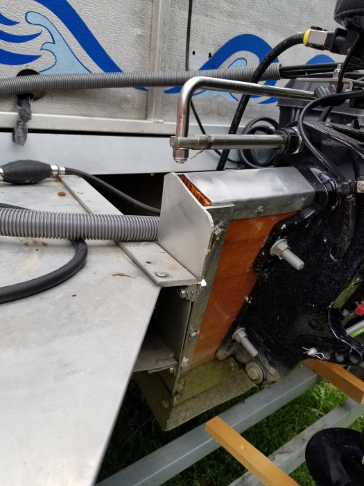

Transom height...
I have 3 and a half inches of transom sticking up above the surrounding metalwork. So... I should be able to cut this down by 2 inches with no problem. I mean other than... lifting the motor, pulling the transom out, cutting the aluminum and then cutting down the wood part of the transom, re-epoxy the cut, reassembling it and redrilling some holes.
And because this transom has SO much negative angle on it, I am consider adding wedges to give it some positive trim.

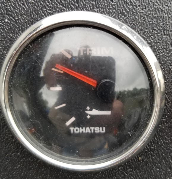

Here's what my trim gauge indicates when the motor is actually neutral trim (anti-cav plate parallel with toons)...
If I add some 2 degree wedges, it should be closer to indicating correctly. There are 5 degree wedges available but they would basically make it indicate just as far off but in the other direct when neutral.
