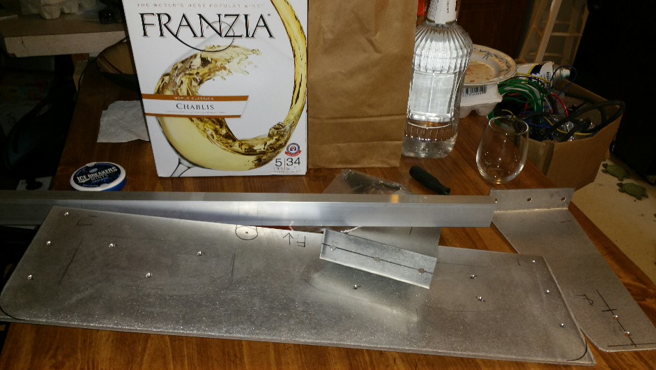

My plan:
I can build her box :P . I have the technology. I can make her better than she is. Better, stronger, faster.
so I cut some alum out and mocked up what needed to be cut and rounded and bent (no way to weld alum. at home yet...so I made an erector set)
2018-05-28 15.11.01.jpg (153.17 KiB) Viewed 1816 times
2018-05-28 15.10.25.jpg (129.33 KiB) Viewed 1816 times
painting
2018-05-28 15.08.50.jpg (217.39 KiB) Viewed 1816 times
start to assemble
2018-05-28 15.09.28.jpg (148.06 KiB) Viewed 1816 times
I used 2" long 10-32 SHCS to bolt sides to bottom and to be used as locators (need to swap for SS bolts)

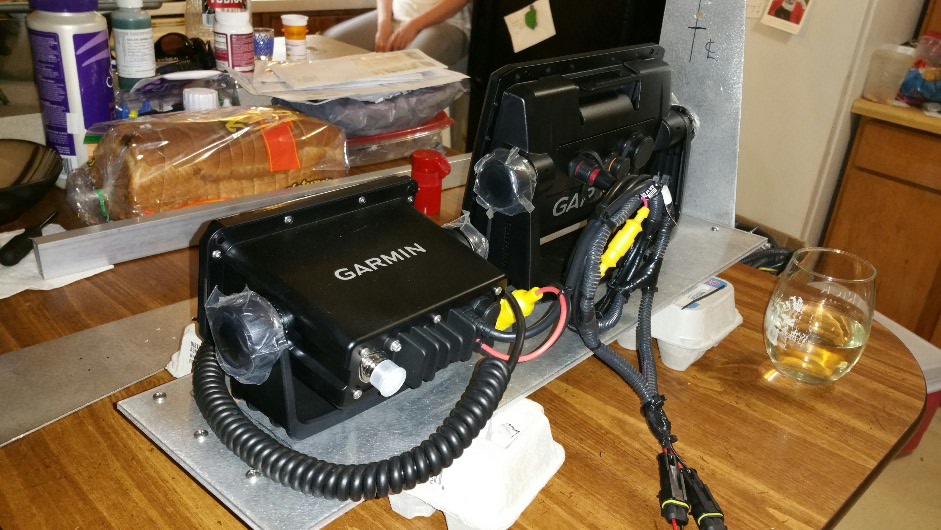

wires tied up and secured with quick disconnect plugs

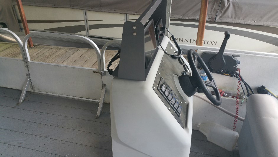

and sitting on console, I drilled 6 holes in the top for the bolts and 1 center hole for cords wires and the Quick disconnects are shoved in the cubby hole in a zip lock bag with an old kooz as camoflauge

it is not heavy, still need a couple latches to secure it, and finish the back cover and sun screen
hope it gives folks an idea or two
