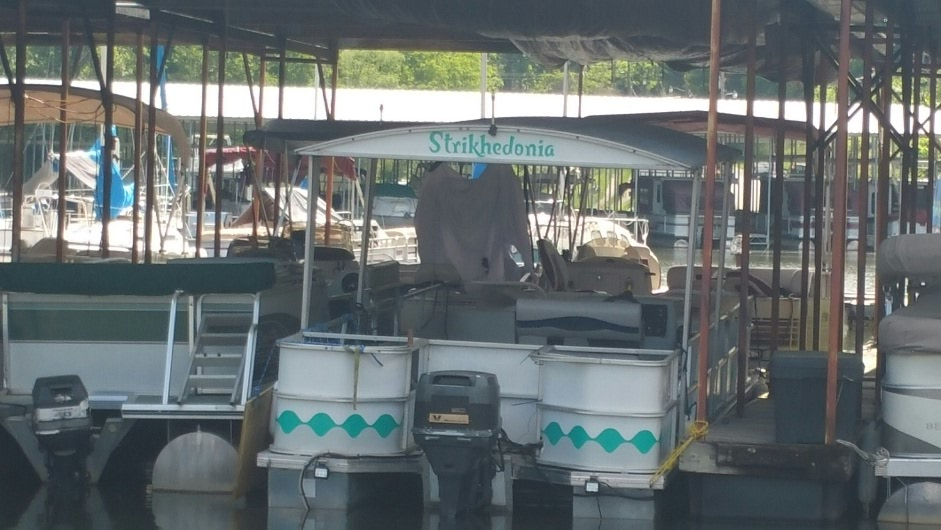

I notice if i trim up even a little bit it gets real loud ,either ehaust ie prop out of water, trimming all the way down does nothing to bow ht or speed.
I hope to get down to boat after work tomorrow and get prop numbers and see how it sits stationary and then compare to under way, engine could be too high which explains trim issue

Also to after reread, it may be too high, i get a pretty big rooster tail

It does sound like motor height needs adjusted.

Sounds like it's too high like others are saying. Also check to make sure RPM reading is accurate.

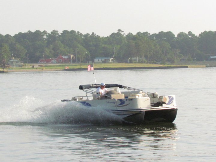

Tell me about the boat---is it rated for 90---or larger motor? Length, number of toons, weight, etc. If trimming up does nothing-you may be underpowered or too much weight in front of boat, etc..... FYI---I have 20ft Lowe 25in toons, 2 fishing seats up front-90 HP Merc Optimax, Merc SS prop 13 x 16in prop 27mph GPS

What HP is it rated for ? Being a 24 ft boat is most of your problem. That's why trimming the motor has no effect-or very little. My boat sits with rear down so it tends to try to get on plane better...as you can see I'm still throwing a LOT of water at 27mph--but trimming does increase speed a lot....I can trim my motor up a lot before it blows out....I cruise at 18-19 mph at 4000-4200 rpms. Redline on my motor is 5850 rpms

Everything points to make sure the ventilation plate is barely skimming surface, if that is true i would have to raise my engine? (From memory), the area above vent plate is more rounded thus if it is under water it is drag and splash back.....i hate when the rabbit hole splits off.... :donno
Hopefully this weekend i can get pictures while wifey drives, still need to check prop also

Yep--raise engine so that plate is even with bottom of mounting pod---which may be hard to do with your transom.. Your boat is too long to trim up enough to get your toons out of the water,,, would take a bunch more horsepower. Show us pics with your new setup.. Good luck.
I had mine out today--26 mph at 5800 assuming tach is correct. Cruising at 18 mph and 4000 rpms....
