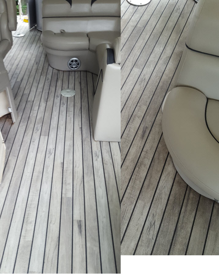

NO CARPET... Lots of discussion on this topic, especially since you are going in the saltwater fishing, beaches etc.. a lot of the major OEMs don't even offer carpet any longer, vinyl and sea grass are pretty much the standard today, this make cleanup a breeze, fish guts, blood just wash away, and you can use just about any cleaning material you want. deck material, some are starting to use composite material, Forest River brands (Berkshire, Southbay, Xcursion) are now using composite. 3/4 marine Grade plywood is still in use across a lot of brands, and is still a very strong deck material, mine for instance has a lifetime warranty from the deck down.

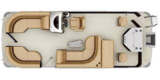

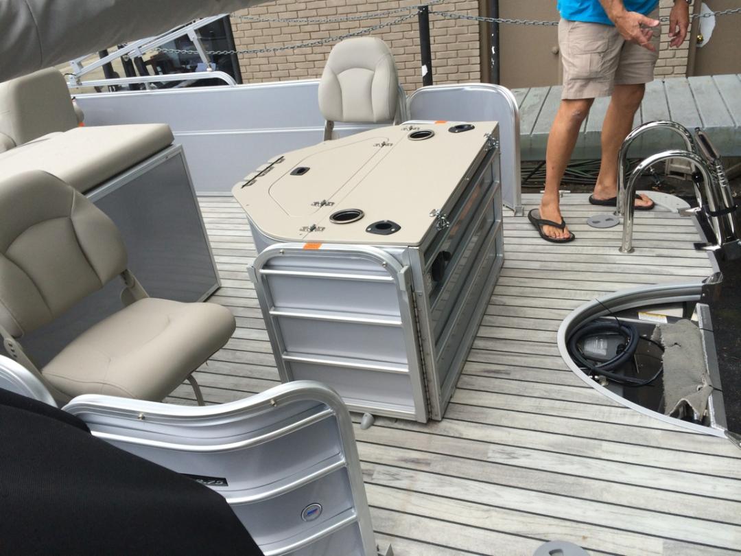

I'm pretty sure almost all Tritoons have under-skinning which is what you are referring to, it would be defeating the purpose of a tritoon which is to gain to performance to leave the underside open for waves and turbulence to catch the stringers. Mine is a Berkshire 231 RFC 24 Ft. Stands for "Rear Fish Front Cruise" Southbay and Xcursion make a similar design, they are all made by Forest River, has a huge rear deck area and built in live well for fishing, then step FWD and you have a really nice seating area for lounging and cruising. Pics of my rear deck area and the floor plan
