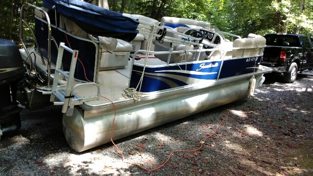

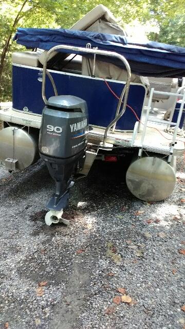

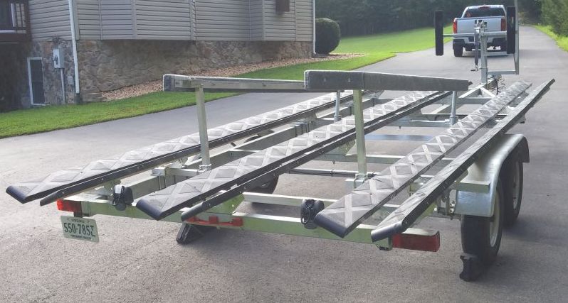

Last weekend saw the following on the access road to our community launch. Person launched their boat, battery was dead, so put it back on the trailer incorrectly. They had in strapped on the front only, and evidently did not get it on the bunk.
My whole reason for post is if you're going to be trailering look into guides similar to the ones on my trailer and also the straps that are shown in the picture also. I too had trouble loading when I first got the tritoon but now with the guides it is real easy.
