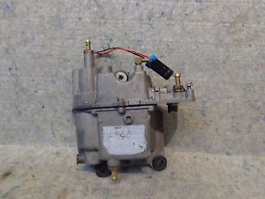

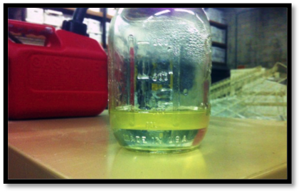

if it is ethanol gas it is probably very bad, as stated we need to know your engine year and model, is it carbureted or fuel injected. take the fuel line off at the inlet of the filter, pump the bulb and get a good sample in a mason jar, let it sit for good while, look to see if there is any separation you will probably see a very clear substance near the bottom. if you have a 4 stroke fuel injected motor, you'll probably need some help, the VST pump is very prone to failure with severely contaminated fuel.

Good suggestions and the pics were great for anyone who may have bad fuel.

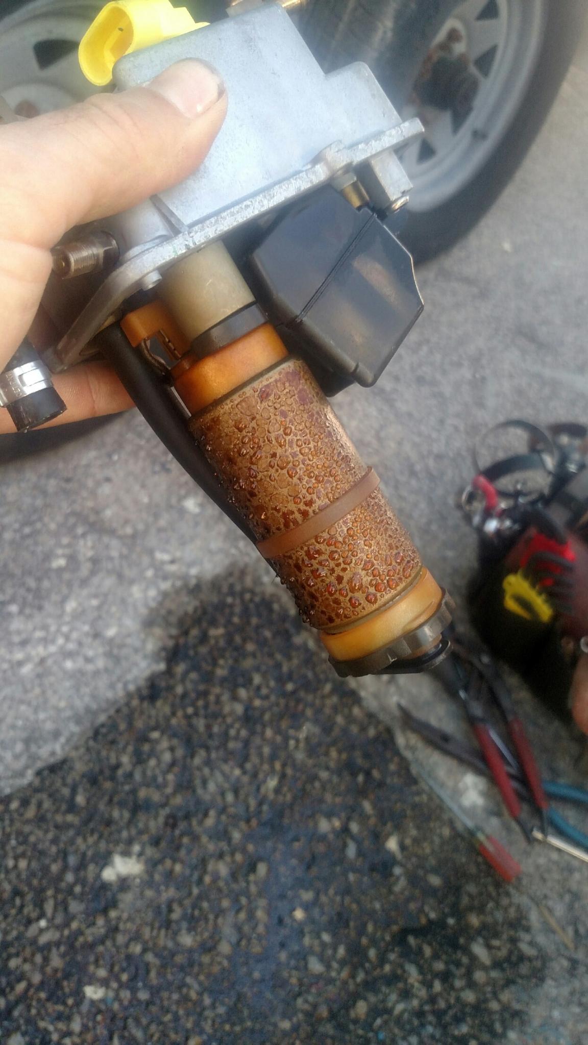

For info on the VST; I have done both Merc and Yamaha, yes at the bottom of the pump which is inside the vapor separator tank (VST) there is a filter screen, usually if there is a quality 10 micron water separating filter (external filter mounted on the rear of the boat) and you use quality non ethanol gas, that filter is normally not a scheduled service item. both 2 stroke (Yamaha HPDI) and 4 stroke fuel injected motors have them. To get to the filter you must remove the tank (bottom half) and at the bottom of the pump there is a filter screen that attaches (in various ways) depending on the engine getting the VST "split open" is the tricky part, most you have to unbolt the tank from the powerhead and move it away a little bit to have enough room to lower the bottom tank half away from the assembly and have room to service the pump and filter screen. here are a few pics that show it assembled, and split. This particular VST pump was completely seized and inop due to the amount of corrosive water ethanol gas mixture that sat in the VST for over a year.Oldchuck wrote: ↑Tue Oct 23, 2018 4:38 amAfter giving it some thought, doesn't the VST also have a filter that could be clogged? I know on many Yamaha's it does.

Thanks for the in-depth explanation of the VST and filter.
