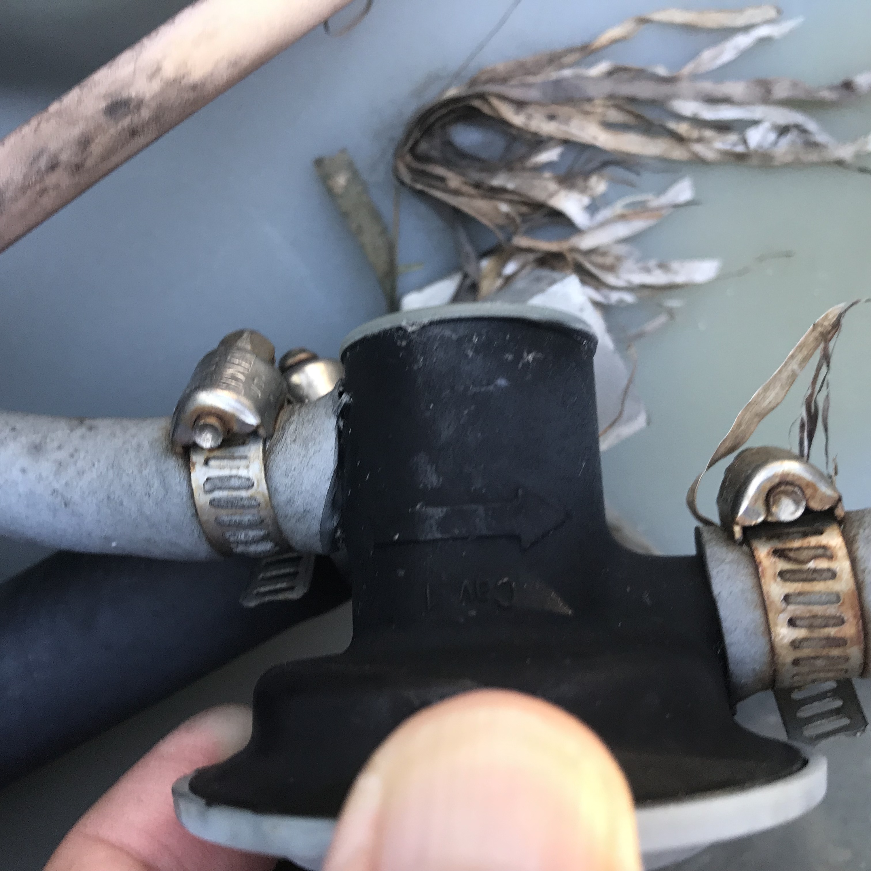

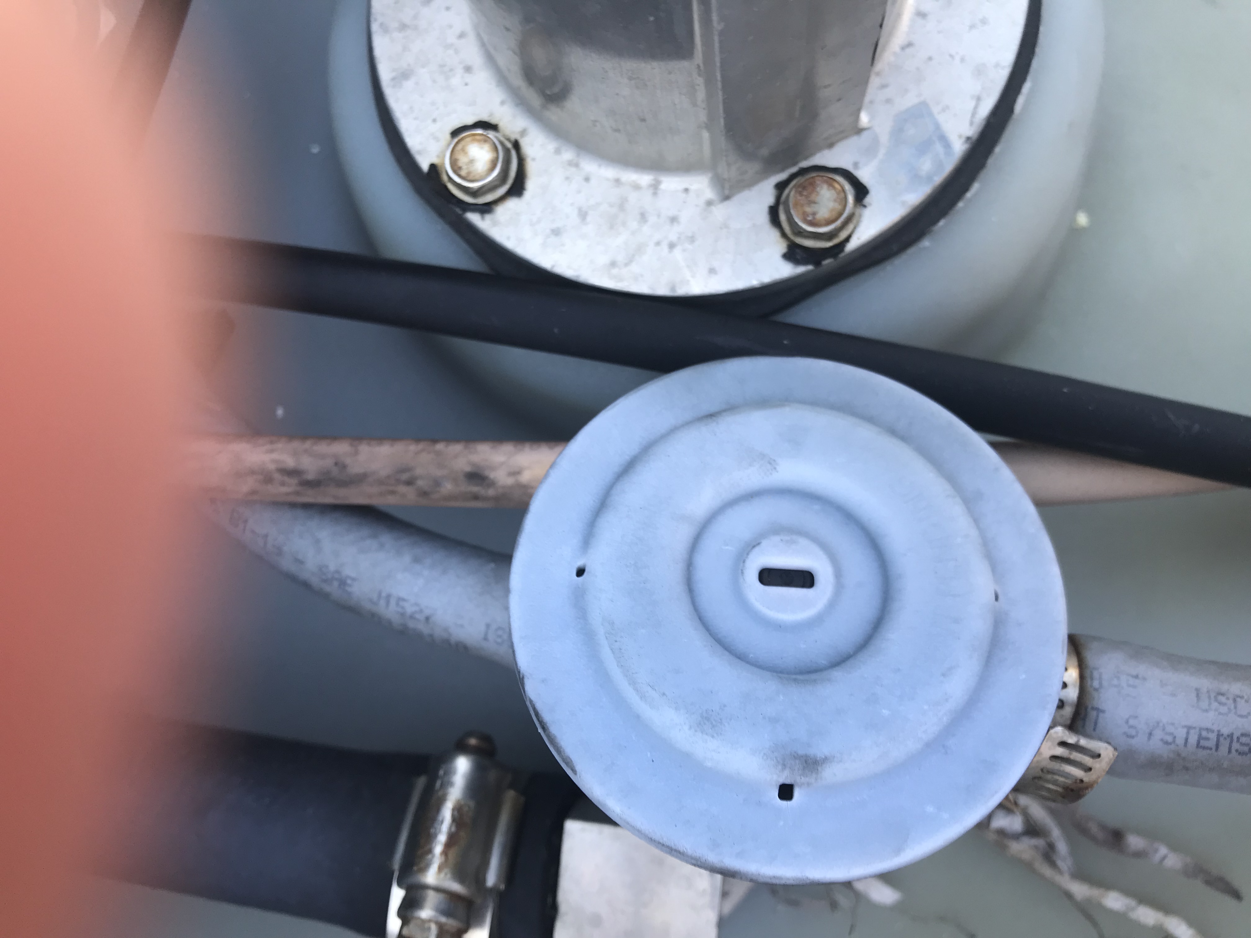

Is this a fuel filter? I’ve never seen one like this.

That is the vent for your gas tank. It let's air in but keeps fumes from escaping.

I should also mention the it keeps pressure in the tank from backing up when the gas in the tank expands. It acts as a check valve.
