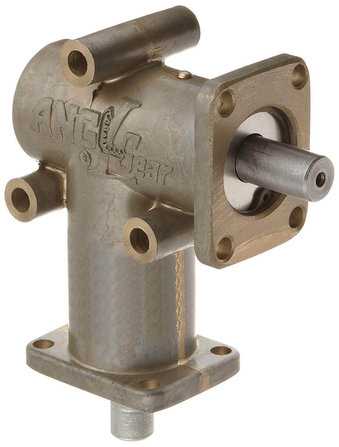

NOW I'm getting somewhere. This right angle gearbox is rated to handle 11hp at 1750 rpm... for $70.00. I'm liking this project now. I'm into $200.00 so far the motor and gearbox.

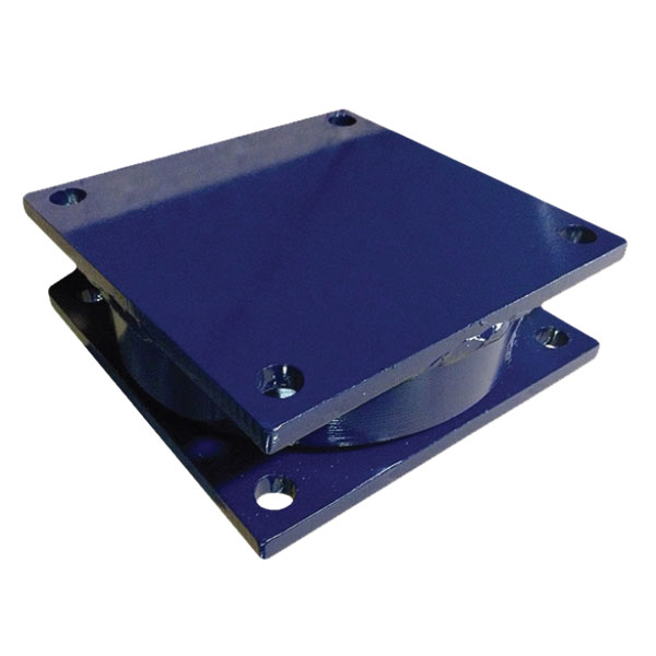

Thanks, those look good but I'm going to need something heavy duty, basically I've got a lever that is going to try to pop the two pieces apart. A serious unit like this would probably work, and it can be ordered with a 1" hole in the center - perfect for my drive shaft. This bad boy can accommodate 1500 lbs. and weighs 11 lbs. I'll need to fabricate a stout plate to mount this to so that I can spread the load over a greater surface area on the plywood.
