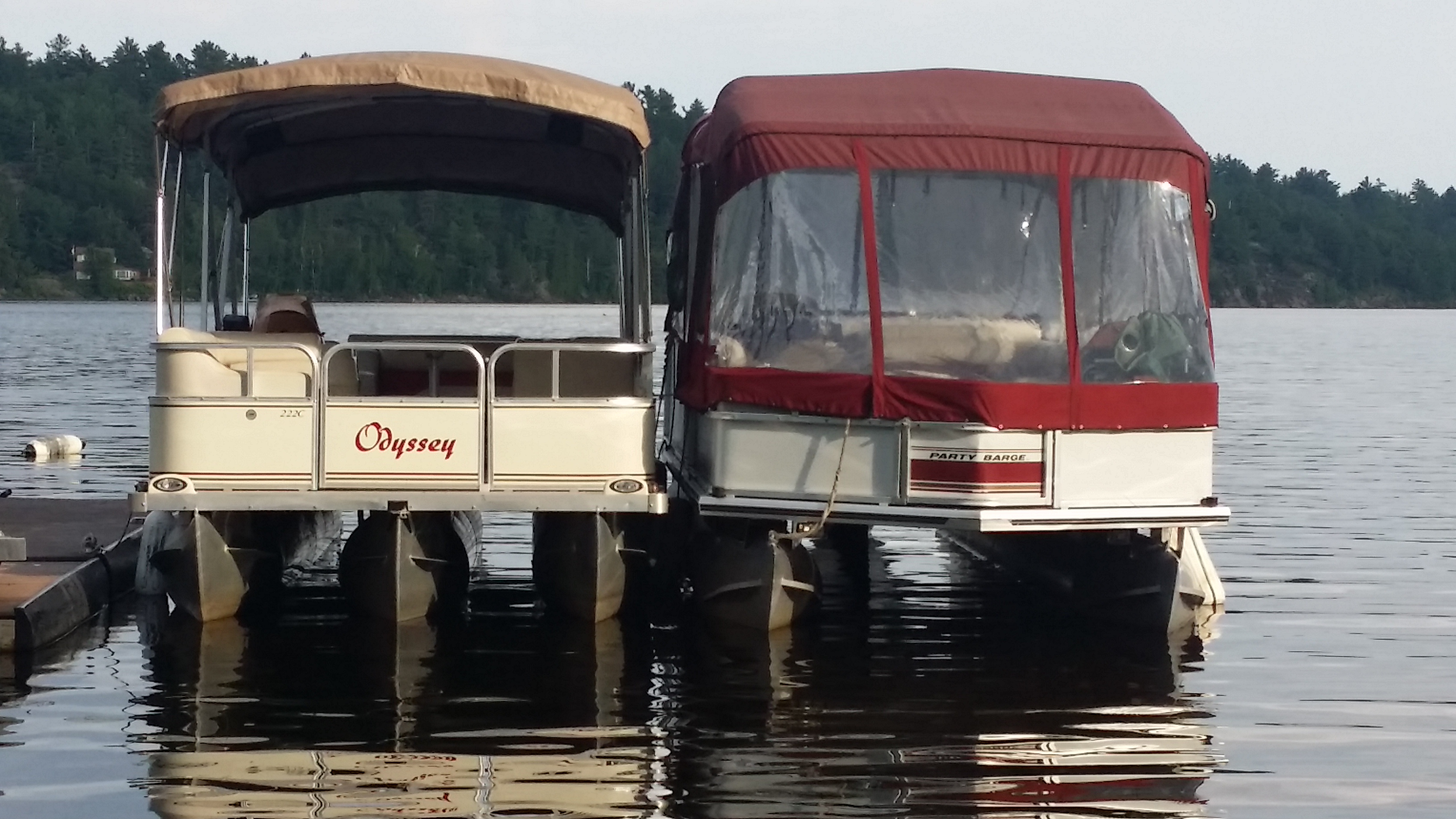

Hey floaters, looking to pick your brains... Years ago I added a third log under my boat (http://pontoonforums.com/viewtopic.php? ... 33#p160433)
Now how much additional weight capacity do you think could be reasonably added the the Coast Guard plate?
The boat is rated for 11 people @ 1495 lbs. Mathematically the third log adds roughly 4000 lbs buoyancy. Is there a formula or rule of thumb to calculate a safe additional load without risk of causing the "pontoon effect" and dumping my passengers? I feel like I'd be comfortable adding 1000 lbs, but science doesn't give a fawk about my feelings lol.
In August we're going on a boys boat trip and I'd like to max out on capacity without drowning my friends.
Thanks
LC.

However, I've done a bunch of calculations based on googled boat specs, their ratings and the volumes of cylindrical pontoons. By taking the total pontoon displacement and subtracting the weight of the boat/motor/fuel, then dividing the remainder by two (https://en.wikipedia.org/wiki/Pontoon_effect) to get the theoretical weight capacity, the USCG rating seems to be consistently 55% of that value.
For example, my boat with 2 logs (23"x22', South Bay allots 625 lbs for motors on boats rated for 115 hp) :
(~8000 lbs displacement) - (1800 lb boat) - (625 lbs allotted for motor/gear) = 5575 lbs remaining/2 = 2787.5 lbs theoretical capacity
2787.5 x 0.55 = 1533 lbs rated capacity (the sticker says 1495 lbs)
Now adding the 3rd log will obviously help, but I'm unsure how to calculate the pontoon effect value given that it's balanced right in the centre of the boat. Regardless, at even 70% of the boat's original capacity with only 2 pontoons, it should safely haul 2000 lbs (allowing for an ~800 lbs margin for my math). So taking the additional 3rd log with 4000 lbs displacement, and only using 12.5% of it (500 lbs) bumps the capacity up to 2500 lbs.
Yes this was a long post haha If you made it this far, does my simple math hold up or is it fatally flawed?
