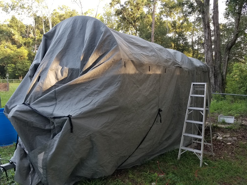

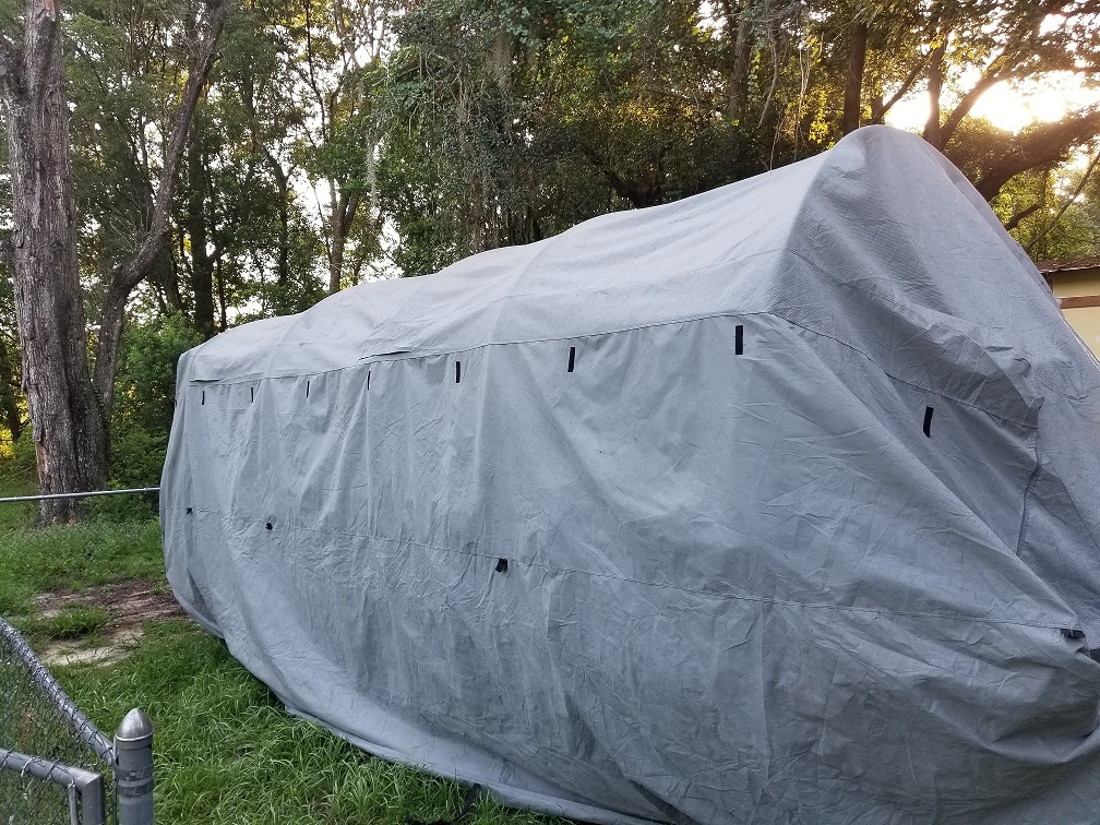

Hello all! so even before I took possession of my pontoon I knew I needed a cover for it. I was looking through this forum and one member used an RV cover instead of a pontoon cover and it got me thinking. I just need a cover for when my pontoon is here at the house, I do not plan on driving with the cover on. So searching website after website I came across this one from Amazon of all places: https://www.amazon.com/gp/product/B00BY ... UTF8&psc=1
I have a 21' Party Barge so I needed a cover at least 22' long.
I had to make some kind of canopy so the cover would lay on and allow the rain and leaves to fall off of it. I used 1/2" pvc, some clamps, and boom...a canopy is made (I have to get some pics of it).
The cover has a zippered side that lines up with the side door of the pontoon perfectly.
This works for me, may not be for everyone, but for the cost of the cover and the pvc parts I'm still a couple hundred dollars cheaper than what a cover specifically for my pontoon would have cost...and I can get in with the cover on and still do work inside.
BTW...I have a fan under the cover to help circulate air. The cover is breathable and keeps the rain out but it still gets warm under there in the Florida weather.

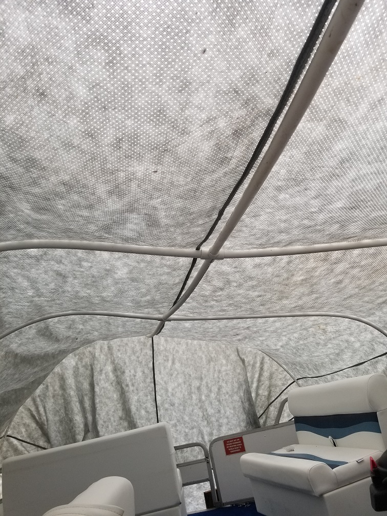

So here is a quick pic of the inside of the cover, the pvc has started to bow so I might have to make some changes, maybe add some supports that sit on the deck.

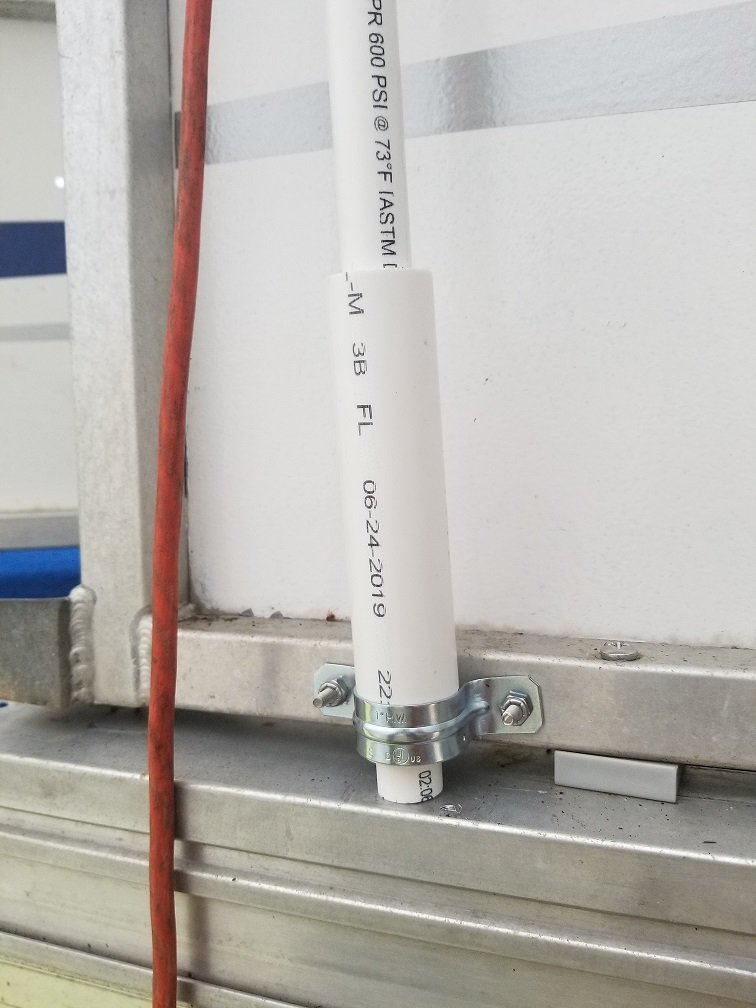

And here is how I attached the pvc. I used 1" pvc and attached it to the fence. The 1/2" PVC just slips into the 1" PVC and is easily removed.
I'll probably make a new version, something more sturdy, but since this was the first attempt I don't think it turned out bad.

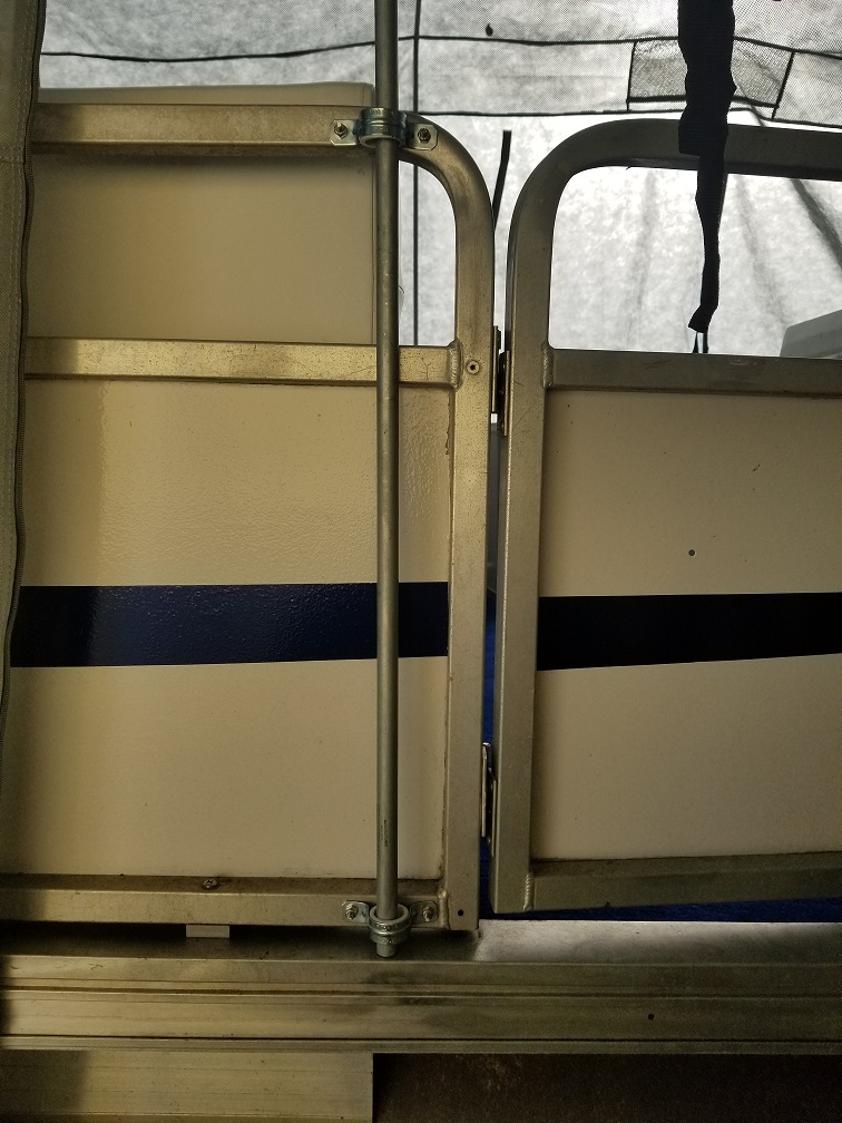

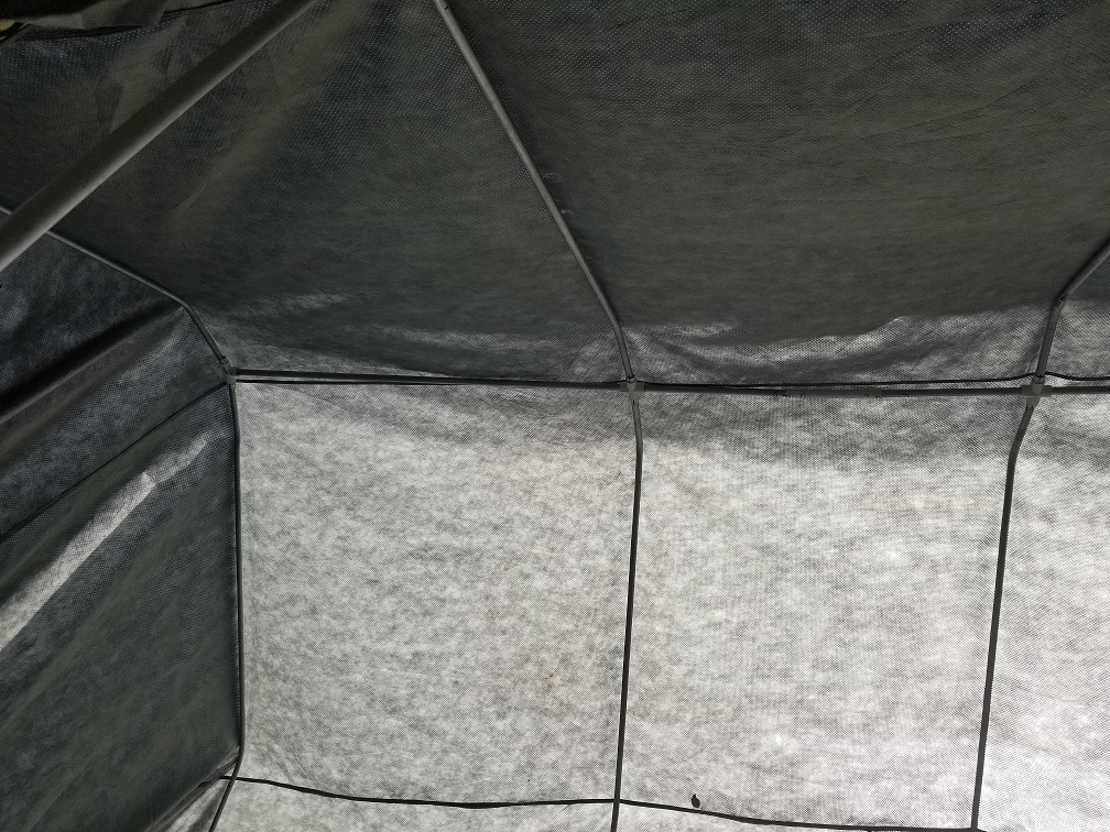

ok...so here is take 2! I replaced the pvc poles since they couldn't hold up, they just started bending under the weight, so I used 1/2" metal conduit and bent the pipe to how I needed it.
The conduit came in 10' long pieces and I kept them that long so that the cover doesn't touch the ground anymore.
I also added another set of brackets to the side to give the conduit more support.
so far much better. still some tweaking needs to be done but overall a better system.
