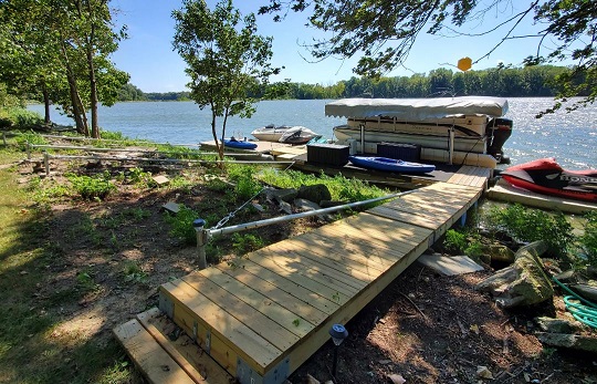

The river fluctuates about 5 feet where I'm at. All of the air hoses are in conduit and attached tightly underneath the lift so no debris can snag on them and do damage.
Also, I have stiff arm connectors with cross cables to support the dock. I used to have dock poles going into the River bottom. This proved to be an issue because debris would catch on them and build up. With having everything attached to shore, the debris just keeps going as there is nothing for it to snag on to.

Here is a picture of the dock setup:
