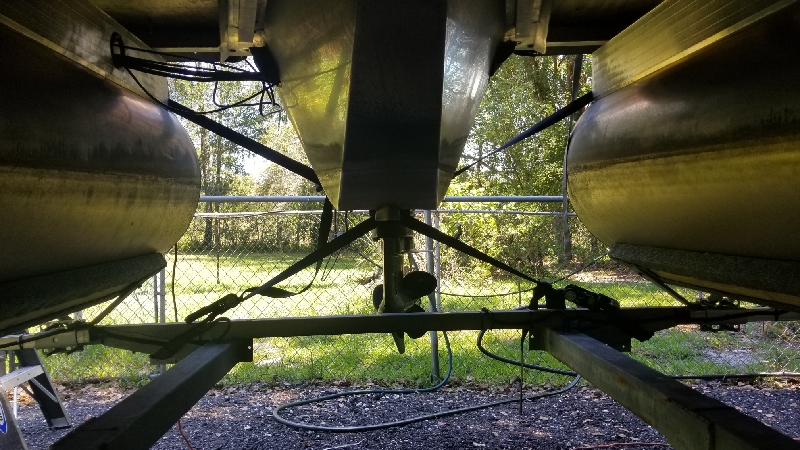

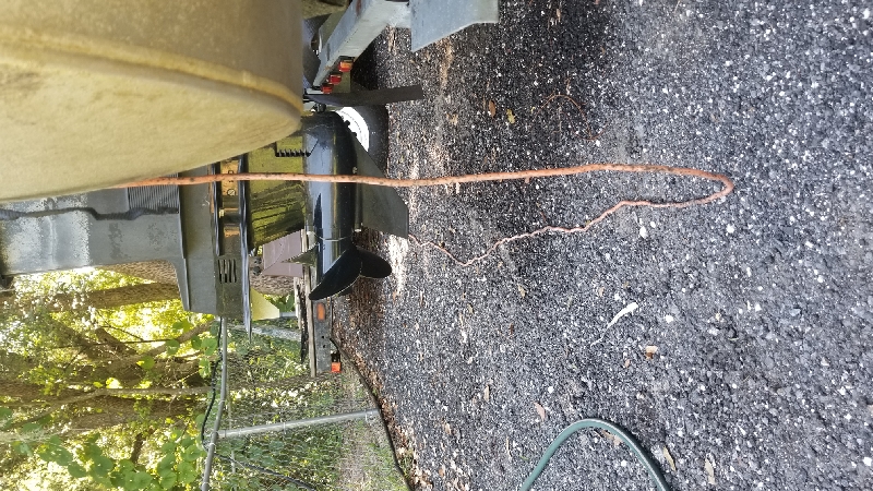

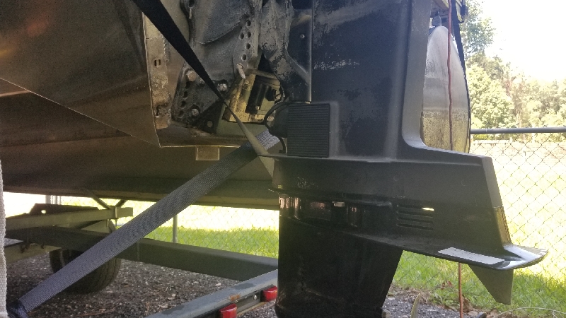

Finally the boat is out of the water so I can take some pics:
And another one...
So now we can see where the motor sits in correlation with the toons and transom.
Does it look like the motor is sitting too low? If I trim the motor up just a little blowout will happen. I keep the motor trimmed all the way down and it works well...so damn frustrating.

Your motor appears to be at a decent height from the pictures. If you're blowing out at that motor height it's going to get worse if you raise it . How is the boat loaded , fuel batteries ,etc? Pontoons are plowing through the water so crazy spray is kind of normal.
Raising the motor doesn't cost anything so if you want to satisfy your curiosity give it a shot. As I mentioned to another member above in the thread a 4 blade prop is great on a pontoon. All the turbulence causes "soft" water that a v hull doesn't ever see. I spent a bunch of money playing with props on my old boat and since a couple friends pontoons. A prop change can solve so many issue with blow out. I swear on my last boat I could trim half out of the water lol

Two batteries, one on each side of the motor, a 18 gallon gas tank on the port side of the back that normally has 3/4 full of gas, 2 people (me and the wife) and we sit in the back. So most of the weight is around the back...I might look into the 4 blade prop...that's a simple change that doesn't cost a lot.
