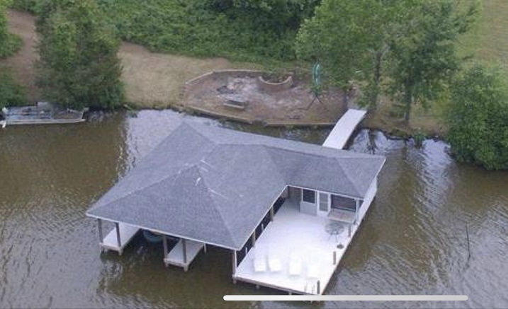

I've had mine at the Lake Anna Yacht Club for the last four years. However, a friend of mine and I just leased a private boathouse with two lifts for this season. Since neither one of us own property or a house at the lake, we're really looking forward to having a boathouse for the season.

#9 Post by JV74 » Wed Apr 15, 2020 8:37 am
How friggin ironic!!! I was looking at that same ad. What an awesome set up. a little pricey but you were smart to share with a friend. Its like having your own place at the lake. I am so jealous!!!!

I thought the price they were asking was crazy, so I gave them a low offer (less than what we were paying for two slips at LAYC) and they accepted. The only thing I had to agree to was covering the expense to have the bunks on the lifts redone. One needed new wood and carpet and the other was setup to hold jetskis and not my pontoon boat. I'm getting that work done for about $250, so I think we'll be all set. We hope to "move-in" this weekend.

#11 Post by JV74 » Wed Apr 15, 2020 10:19 am
Awesome......smart man! The place looks brand new in the pics. Would u be allowed to stay the night if u wanted to? I saw in the original ad that there was a room with a tv or something like that. It also looks like there is a big fire pit too!!! Maybe you could bring a rv or pitch tents? Maybe the neighbors wouldnt be too happy about that.
