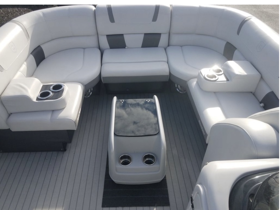

- Seating
- 8736D8B2-427D-4866-B5CC-ED30B1D2762E.jpeg (140.71 KiB) Viewed 8070 times

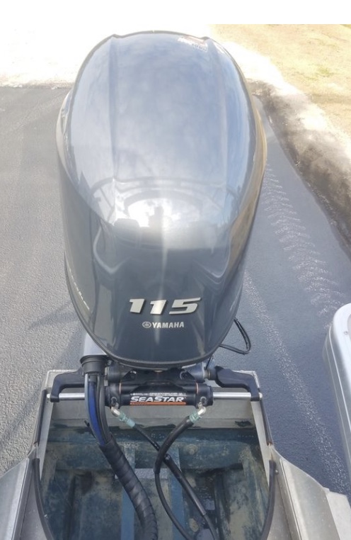

- Motor
- 38CE3A16-E9D7-4023-99EC-7DF7A1F98A0F.jpeg (107.8 KiB) Viewed 8070 times

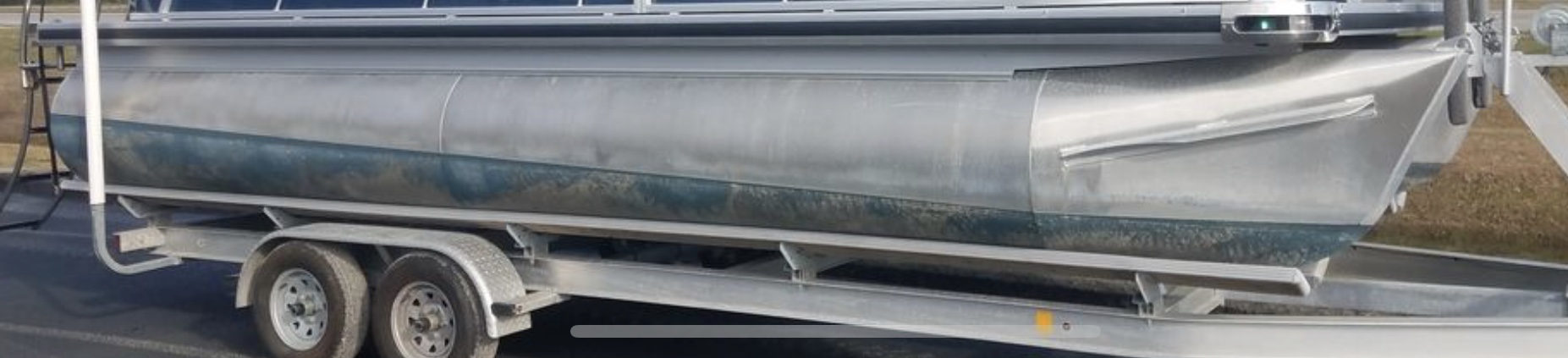

- Toon with anti-fouling paint
- 3593E147-082E-48F8-BD34-FABD8641619F.jpeg (173.53 KiB) Viewed 8070 times

Just me, but personally wouldn't touch it if you can't guarantee how upkeep was done every single time it was used. Very important to flush the engine for several minutes after each and every use. Also supposed to change out the outboard anodes to a different material for salt water use, that includes the internal ones. Oil fogging the internals during extended down time goes from being a case by case necessity around fresh water to pretty critical if kept near/in coastal environment. The bottom paint looks like it was applied for trailering after salt water use just to prevent corrosion between the bunks and logs, not for leaving in the water but I'm not an expert on bottom paint other than thinking it's supposed to cover any part that's submerged. If it's on its second engine....Why? Typically any warranty that would cover corrosion (logs, structure, welds) is voided by salt water use unless a coating is applied by a licensed applicator, not sure about it if the boat is a "salt water series" but don't know if Aqua Patio even makes one of those. Too many good deals out there on boats with the pandemic to gamble on one like this but maybe I'm either too scared or just don't care enough about money. Where are you in SC? I'd assume near the coast?

The only reason I ask is the toons don't look terrible (from the picture). Depending on how long it sat unused, and depending on what water, I would think there would be more barnacle growth...unless it has been scrubbed. It may also have zinc anodes already, which might be a savior for the motor. I agree with Steiner, hopefully there was flushing done - hopefully on a regular basis.
The only reason I would consider it would be that the interior looks to be in perfect shape, and the toons don't appear to have any damage. If you had the toons and frame carefully checked for corrosion and leaks, and if you found zinc had already been used all over, and if the motor checked out fine, you might have a really nice boat at a fraction of the original price. But those are some heavy IFs.

The upholstery does look immaculate and they had custom covers made for each piece besides the standard covers. Everything inside looked pristine. My concern was salt water and how it impacted the outside and mechanicals as I’m new to this. Visually looks great.

Assuming the bottom paint is appropriate for an aluminum boat it is probably fine. I would find out exactly what the dealer put on it. The wrong bottom paint on aluminum is really bad and can hurt the toons. 27 hours on the motor is very little. The 115 is not known for having corrosion issues. Many last years without even being flushed. If you get it run some salt away through it. I would make sure they have the correct anodes on it. When I kept a boat in saltwater I had divers clean the bottom once a month. Bottom paint is critical in salt water. Other issues can be electrical problems but the boat is not very old so you are probably ok. I would check the connections and see if there is corrosion. A little is to be expected. A lot may be an issue.

Tried to think of something not mentioned above. From my 10 year salt water experience, inspect all the electrical really well for corrosion, especially the fuse panel. Hopefully they kept it sprayed with CRC to protect it. I'd want to see service records for the engine, and pay attention to the last time the impeller was replaced. My normal maintenance included replacing them each year.
