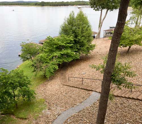

Thank you all for your replies. Hopefully a 12 gal tank will fit. It is a long walk from my house to my dock. Don't think I want to juggle gas tanks.

A 12 gallon tank is going to be about 75 pounds. That's a lot of weight to carry down those steps.
You've got a beautiful back yard, but it's a perfect example of why I'll never have a boat on a lake that doesn't have gas at marinas on the lake!
Exactly. I want a large portable tank that I can use as though it is a permanent tank. Zip to the marina, fill it up in place, and go fishing.
