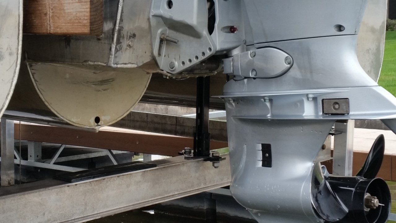

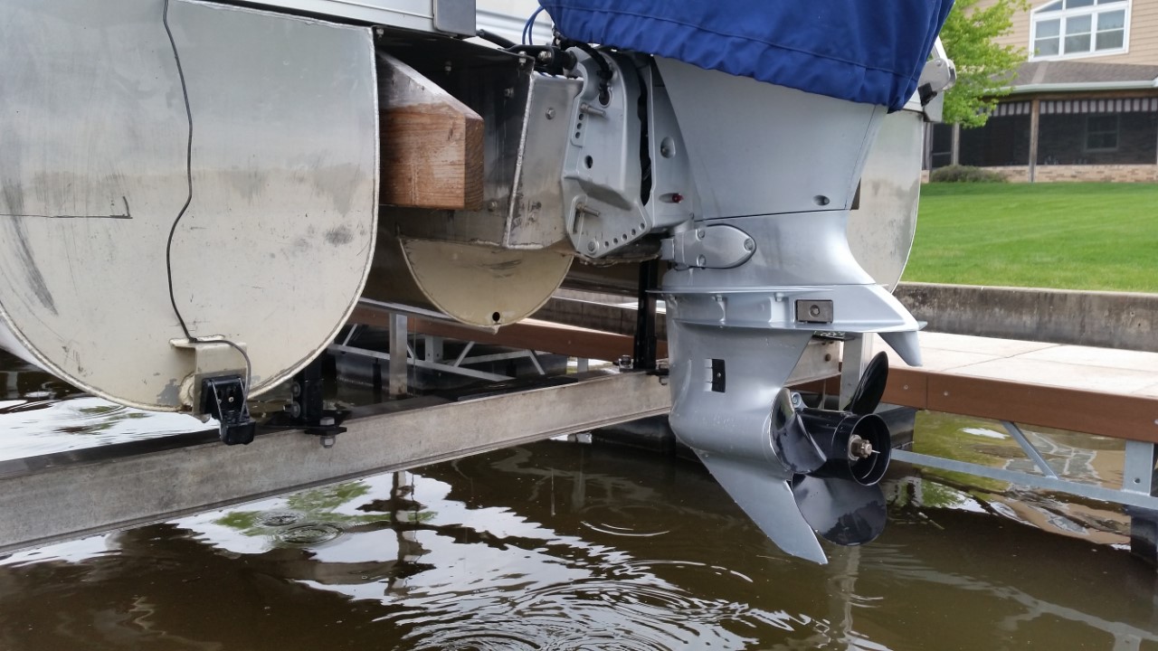

These are the old pics I have after lowering it but when it was on the trailer and level, the cavitation plate was still about an inch higher than the bottom of the middle toon.

I think the major problem is the cavitation plate is above the center ‘toon. You need a longer/deeper shaft-length/prop-depth.
That prop, at speed, is up at the surface behind that center ‘toon.

That what I was/am thinking too but Woody another member here had basically the same boat (but w/ a Honda 135) w/ the same issue. He said he managed to get it working by adjusting the engine height (guessing lowered all the way) and going w/ a Stainless 15p prop.
That's also why I tried a stainless to get more bite.
Right now there is no way for me to get the motor any lower. I can't seem to find what it would take to make this long shaft into an extra-long shaft.
I was looking into jack plates but none of them will lower the engine any further, they are only designed to raise.
I did find this static jack plate and was thinking about trying to flip it around?

The transom on the above boat appears to be non-typical in design at least in the photos as provided. As it is now it appears that the water is coming in under the boat and the smooth transitional flow to and through the prop is being spoiled by transom design issues that are creating problems.
Re: Figuring correct prop
I agree. I think that's a JC brand because they use those U shaped toons. But I'd be willing to bet that wasn't the original motor. I don't see any way to get that motor down low enough to get the cav plate where it should be. I'm guessing the original motor was either a long shaft, or perhaps the boat was built for an electric motor.Bamby wrote: ↑Mon Jun 01, 2020 1:06 pmThe transom on the above boat appears to be non-typical in design at least in the photos as provided. As it is now it appears that the water is coming in under the boat and the smooth transitional flow to and through the prop is being spoiled by transom design issues that are creating problems.
