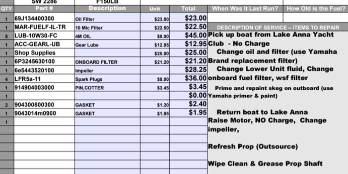

My total for this service was just over $800. Obviously, it's for a Yamaha, but this will give you an idea of what they did and what they replaced

If you had a similar parts list to what I showed above, $350 is crazy cheap. That's less than $150 worth of labor. Somebody is severely undercharging for their time!

1 Oil Filter.............................12.99
1 Impeller............... ..............43.90
1 Impeller gasket..................... 5.20
1 ( can't read his writing............11.99
4 spark plugs..........................23.44
1 gear lube............................15.00
1 fuel water sep. element..........13.84
5 qts. engine oil..................... 32.90
Parts total............................159.26
Labor charges ( $70 per hour )
change out water impeller & Gear lube @ 1.5 hrs..............105.00
change oil and filter,, 1/2 hour.................................... 37.50
change fuel water seperator filter, clean engine fuel
filter and change spark plugs 3/4 hr............................. 52.50
Grease wheel bearings on trailer................................. no charge
Total Labor........................................................... $195.00
Total Parts........................................................... 159.26
Tax................................................................... 33.12
TOTAL BILL............................................................387.38

Looks like our parts lists and pricing are reasonably similar. Your big savings are on the labor.. I didn't know anybody was still charging only $70 an hour for labor. That's a great price. I'm guessing it's a one or two man shop? Or a trunk slammer?
It's unfortunate (for him) your guy doesn't know now much he's truly worth.
