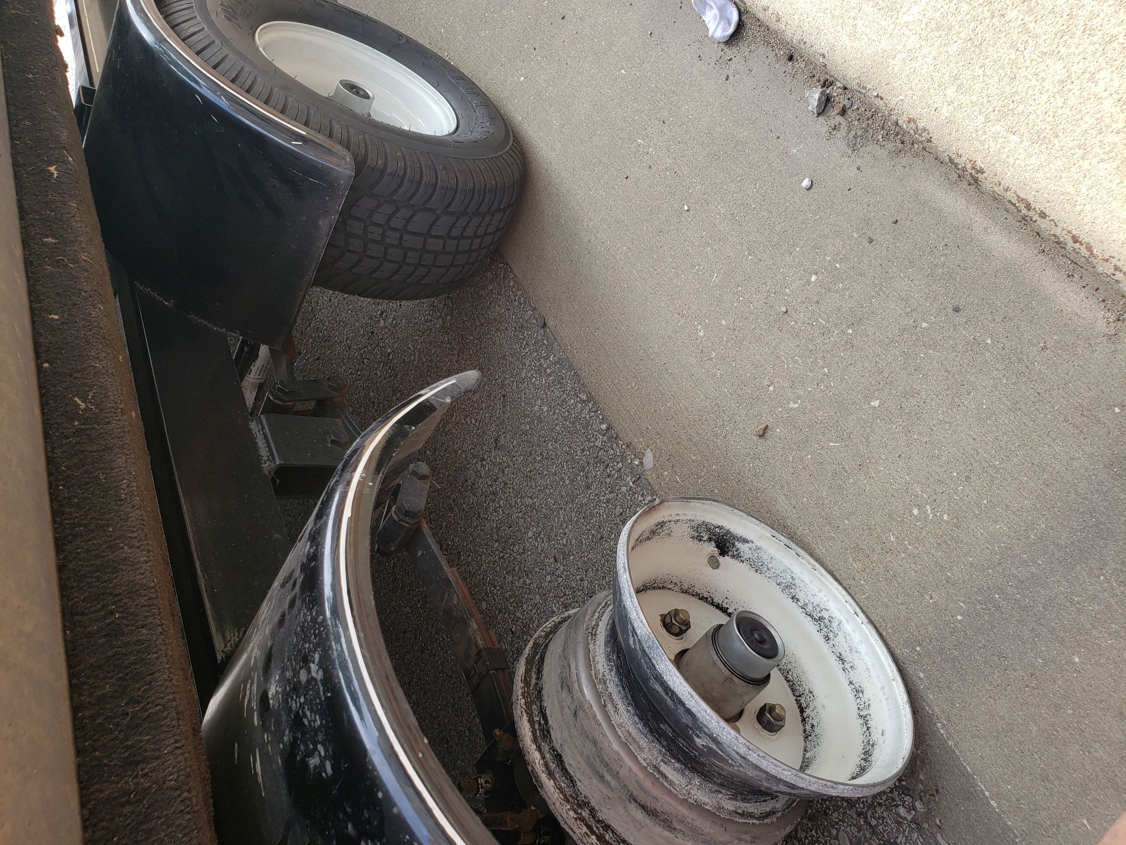

Soooo....had grandkids visiting us in Kentucky from Cincy and wanted to take them out on the river for awhile. I'm tooling along with my grandson in the truck, listening to his music on the stereo when I start to hear a scraping, grinding noise coming from somewhere...yeah its coming from my rig somewhere....pull over in downtown Owensboro main street, and someone on the street is hollering that I've lost a tire on the trailer. I don't know the details, but I must have run over something and cut the tire down. Then a guy on a bicycle rides up and says he saw it fly off the trailer several blocks back, and it was nearly on fire it was so hot. A quick call to AAA and they got me going in about thirty minutes. I've been meaning to put a jack in my truck,but didn't and now it bites me in the ass. Ruined the wheel too.
- trailer wheel.jpg (912.43 KiB) Viewed 16798 times

Ouch, that sucks. All the years towing; those type tires are only ones I have ever had problems with, I have those once again on pontoon trailer. I think since they are so small they just spin everything faster and make more heat....

Wow. I carry spare but also a little go bag with foot pump, gauge, breaker bar, and plug kit....you didn't leave a whole lot of that one to plug though! Main thing is everyone is safe. Imagine running 70 down a 6% grade and seeing that tire in your review say "Adios, bitches!"

We made it to the mighty Ohio river and enjoyed several hours of boating, but the storms arrived right on time, (after missing the rain forecast all day long) so we made a dash for the dock. I agree that these smaller wheels probably build up heat quicker due to more revolutions to cover the same distance at a given speed, compared to larger tires and rims. With the trailer being a tandem, I never see the rear tires and axle unless going around a corner.
